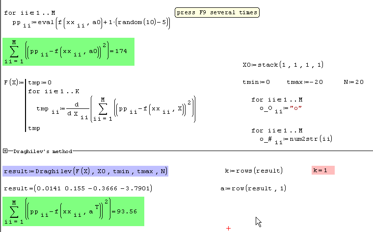

#25 Опубликовано: 06.10.2012 10:06:38
20 points (~24 sec). I made some little changes in Draghilev() function.
Draghilev's method. NLS. Example 2.smz (6,17 КиБ) скачан 1321 раз(а).
Radovan Omorjan 06.10.2012 10:41:00

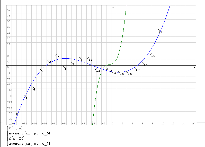

#26 Опубликовано: 06.10.2012 11:02:10
Hello uni,
It is quite interesting that you've made it working with 20 points .
By the way, I've added the sum of squares - just to check how this sum reduces its value.

Yes, but initial value for a is X0 := stack(1, 1, 1, 1)
#28 Опубликовано: 06.10.2012 12:20:33
Sorry, uni, my mistake . Graph distracted me
In this example - this is really amazing
If this could work for a bit more complicates functions - it would be really great .

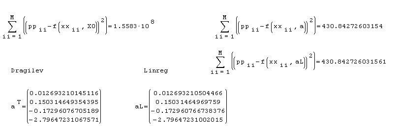

#31 Опубликовано: 07.10.2012 06:20:29
Hello uni,
It seems very promising
As it is basically a linear regression over parameters (polynomial equation) I just added the result of it - just for checking. The results are very close to each other. It is interesting that the method is working on this problem very well
The determinant [MATH=eng]det((transpose(XX)*XX))=2.40082615642816*10^16[/MATH]is rather far from zero - well conditioned system. I suppose that would be very interesting to see what will happen when this determinant is quite close to zero - ill conditioned system. I suppose that the results must be quite different.

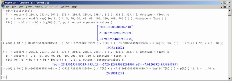

#34 Опубликовано: 08.10.2012 05:42:03
Radovan, it's really hard to get a solution using the Draghilev method. I do not know how to do it yet.
The solution here is: [28.4502559095434933, -2720.12633981294994, -7.01208324395984839]. Maybe later I'll be able to get it.
Davide Carpi 09.10.2012 03:32:00, Radovan Omorjan 08.10.2012 08:02:00

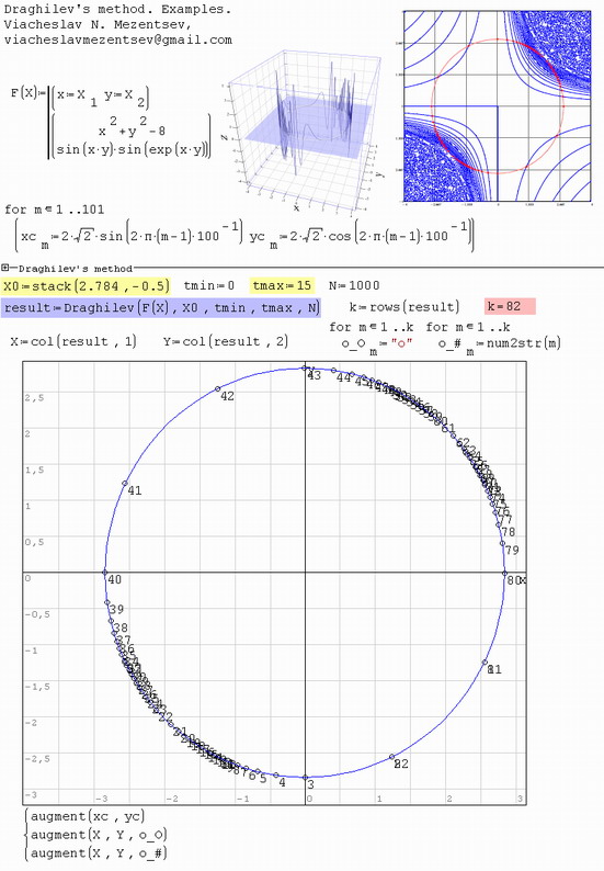

Example 5. Finding roots: System 4.
[MATH]sys(x^2+y^2-8=0;sin(x*y)*sin(exp(x*y))=0;2;1)[/MATH]
I made minor changes to simplify the calculations. Function has become more clear.
Calculation time: ~1.5 min
Roots: 80
Radovan Omorjan 11.10.2012 02:36:00
