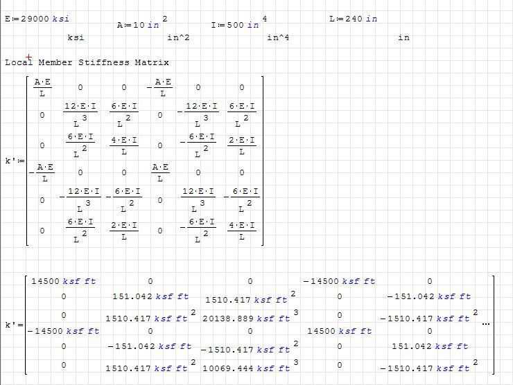

#6 Опубликовано: 18.01.2017 18:45:25
justhumm
justhumm
0 сообщений из 18 понравились пользователям.

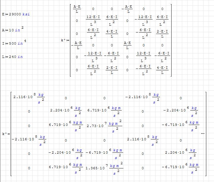

When using a matrix with elements of a variety of units, is there a way to control the display of the resulting units (imperial instead of SI units)?
For instance, in the attached image:
k'(1,1) = A(in^2)*E(ksi)/L(in) = kip/inch, but results are in kg/s^2
k'(3,2) = 6 * E(ksi) * I(in^4) / L^2(in^2) = kip, but results are in kg*m/s^2
#7 Опубликовано: 18.01.2017 19:57:29
Hello [userlink]justhumm[/userlink],
You can try using
OutputUnitsSystem=Imperial
instead of
OutputUnitsSystem=Metric
in
%APPDATA%\Smath\settings.inf
(it is an experimental feature)
frapuano 19.01.2017 06:13:00, justhumm 18.01.2017 20:44:00

Davide Carpi:
Thanks for the response! It seems to be working.
Wishlist item:
It would be nice to have the ability to switch between feet and inches for the default imperial unit. :-)

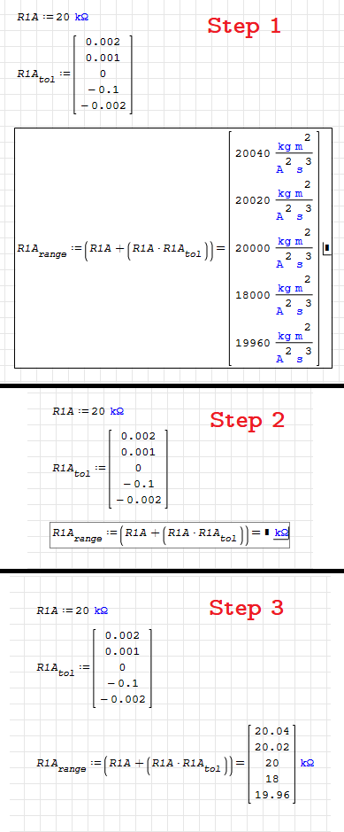

When using matrices with units the results are given MKS rather than in the input units as shown here:
Units with Matrices
What an I needing to do to show the correct units?
#11 Опубликовано: 14.02.2022 20:46:07
- After you calculate and get the result, click on the expression or move your cursor with keyboard to it (Step 1)
- There should appear a placeholder on the result part, write there your desired output unit (Step 2)
- When you press enter or click outside or just loose the focus for expression, your output shall be in your input units (Step 3)
#12 Опубликовано: 14.02.2022 22:06:05
Mark R Harris
Mark R Harris
5 сообщений из 90 понравились пользователям.
Thank you so much Overload, greatly appreciated.

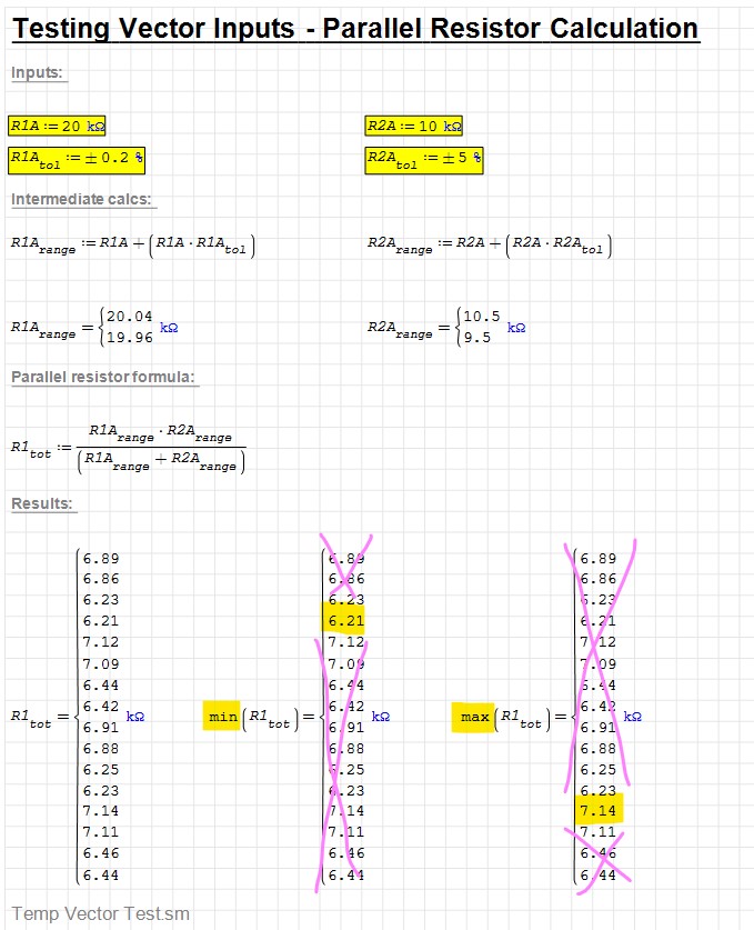

#13 Опубликовано: 14.02.2022 23:08:20
Mark R Harris
Mark R Harris
This is getting so close!
I've tried the plus-minus function, but can't get the min or max element values. I suspect this is because the result isn't a maxtrix:
edit by mod: please use the forum attachment feature; images stored outside the domain soon or leater expires or are removed and the topic becomes unreadable. Thank you.
Or it could be my 'PBCAK' (OSI layer-8) problem...
#14 Опубликовано: 15.02.2022 07:47:55
That's the cause, yes. You can use sys2mat() function from custom functions plugin or Max()/Min() functions (uppercase M) from the same extension.

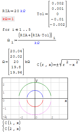

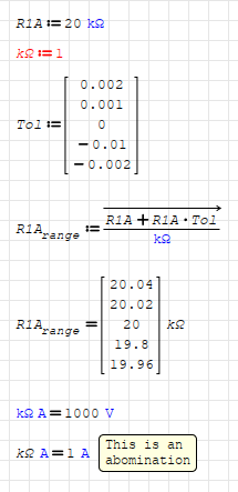

Thank you Jean, that is very elegant. What was the function of the red kOHMS:=1?
#18 Опубликовано: 16.02.2022 13:56:11

#19 Опубликовано: 16.02.2022 14:28:13
Actually it is not elegant, very primitive method only used by Jean.
He just continues to try to confuse new users.
He make his own units, not compatible with ISO units.
Which is the case here, he assigned a new red colored Ω to 1. (Ω:=1)
That red Ω is not V/A, ask him to divide it to volts. He won't get 1/Amper.
Don't use his methods, them are just bad practices.
Oscar Campo 11.03.2022 22:52:00, Jason McCool 23.02.2022 18:31:00
#20 Опубликовано: 16.02.2022 15:05:33
Jean's math is unitless crusade is garbage.
We don't only do pure math calculations.
Engineering and science needs units.
As I have said before;
Math is unitless, science/engineering is not.
Jean's "silence unit" crap is useless, confusing.
As it is shown below.
Oscar Campo 11.03.2022 22:51:00, Jason McCool 23.02.2022 18:30:00
