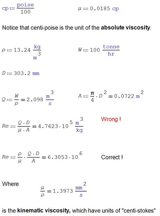

#63 Опубликовано: 08.04.2022 23:54:39
Ok. Here is an excellent example of why units should be used in engineering calculations:
In that example of 100's Orifice Plate, all process data
are given by the Chemical Engineering team in Engineering Units.
The Consulting Instrumentation Engineer do two things:
1. best find "ΔP[Pa] ... User XTR" to minimize the models XTR's.
2. calculate the the bore diameter for all 100's plate.
On the turnkey day of the multi billions $ Plant, SI is not invited.
Let's look at how calculations turn out if units are used.
Reynolds_Wrong_Calculus.sm (9,11 КиБ) скачан 1565 раз(а).
It's very easy to make pretty serious mistakes by not using units.

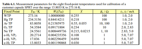

Inst_Type Pt100, Ge, T, J Copy.sm (537,44 КиБ) скачан 1818 раз(а).
Wr with a resistence, which is not. It is a ratio of resistances. And how you assume that all units are equal to one, and with which you make the reader lose any idea of ​​the dimensions with which you work. That is why you get to calibrate in that document a PT100 (which should have a resistance of 100 ohms at 0 Celsius) with values ​​between 0.5 and 1.5 ohms, which is completely absurd, if the units you handle were correct.
That is, the number Wr is dimensionless, so there is no problem raising it to 1/6. And if it had dimensions, it would only be necessary to divide it by its units, as is done in practice.
That is to say, another document with serious conceptual and result errors simply for not using units. As margin note, you asume also that because for Germanium is used with mV for sub-cryogenics measurements you think that for Platinum is the same, but for that the unit is mA (for a 4 to 20 mA control loop) because the power that dissipates could be much greater.

From your SMath file ( https://en.smath.com/forum/resource.ashx?a=43693&b=2 ):
and
From the NIST ( https://nvlpubs.nist.gov/nistpubs/SpecialPublications/NIST.SP.250-91.pdf at page 77)
There you can see that Wr is dimensionless, and can read how to define it as a quotient between resistance's. What you get, 0.59493791 and 1.77363368 are not fake ohms, as you type. Are the relation between the Platinum electric resistance and the reference value for the water at 0.01 Celsius. It is very practical because it is very easy to obtain temperatures of 0 C and 100 C with enough accuracy in the work area inside the plant, without having to disassemble the instrument and take it to the workshop workbench. It is PT100 because 100 ohms, otherwise it would be called PT1. You can google it. Actually there are also PT1000, whose nominal resistance is 1000 ohms at 0 C
