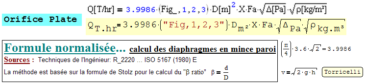

Your ISO 5167 is not the working version.
Order the hard copy, check if you can do the example
as given by the Process Team.
Instrumentation Engineer greatly assist the piping Designers.
After my valve sizing 2", the original 6" vanadium pipe 100m
can be reduced to 3" pipe depending upon availability & $ kW/hr.
at the cost of vanadium !!!
They paid me Gold Bridge for results.

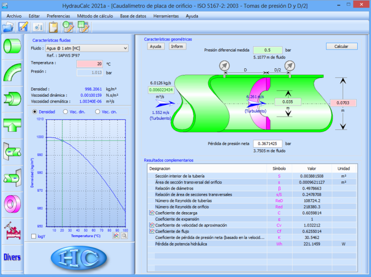

I already have the standard document, any calculation made according to latest 2003 ISO can easily surpass your primitive example.
You lack the abilities of a proper engineer. As I have said, you did made your career when human resources are limited.
With your lack of knowledge and false claims you wouldn't get a job nowadays.
Simply, do the example above or one of your choice.
Why would I do your calculations "properly" without getting paid?
Do your own job and correct them, according to latest standards.
And stop spreading to new SMath users about your unitless bullshit!

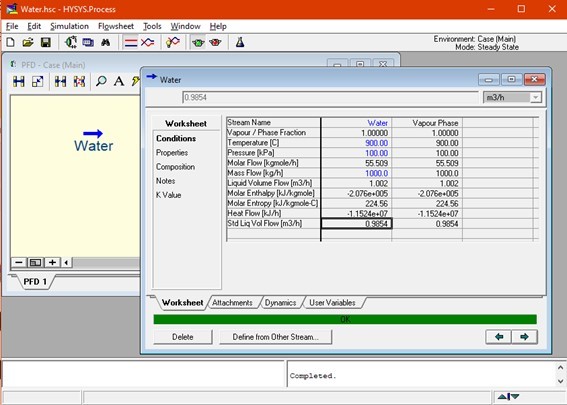

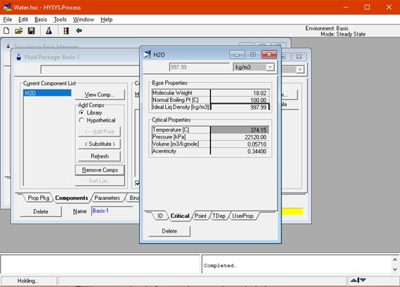

It is a fairly common mistake to think that to go from the reading of a mass flow meter to a volumetric flow, it is enough to know the density at the temperature and pressure of the reading.
First let's see how it is handled by a software, for example Hysys. It does not have a single volumetric flow, but also introduces a "Std Liq Vol Flow"
The density to use for mass to volume conversion is stored in the critical properties information of the compound.
Information about how the conversion is done in the program is on pages 55-60 of this manual:
Pages from SimBasis appendix A property packages.pdf (280,97 КиБ) скачан 1513 раз(а).
For the conversion of readings in real instruments it is necessary to go to the information of the manufacturer of the instrument. Some examples on how to convert standard or actual mass to volumetric flows readings units appear in this article, highly recommended for those who don't know how to use units in process plant instrument readings.
gnan1402.pdf (1,22 МиБ) скачан 1149 раз(а).
In conclusion, the only thing I see are well-managed units in all the showed calculations.

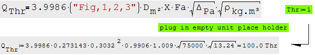

Thanks Alvaro.
Mass flow is bog-standard for people to understand nowadays (IC engine management has made it so commonly studied), and the units are exactly correct (ie what they say they are).
The good thing about using units correctly on the inputs to a formula is that if the output isn't correct units-wise then something needs to be fixed.
Smacking a Unit:=1 onto it is not at all helpful (ie can be better done as a simple comment without the units operator-overloading declaration).
WroteSmacking a Unit:=1 onto it is not at all helpful
Exactly, that is what Jean can't comprehend.
