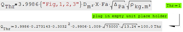

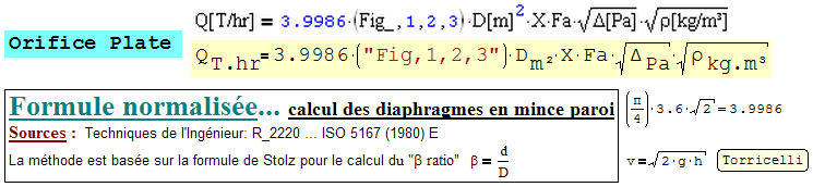

You use 1980 version of ISO standard and call 2003 version crap?

Your ISO 5167 is not the working version.
Order the hard copy, check if you can do the example
as given by the Process Team.

Simply, do the example above or one of your choice.

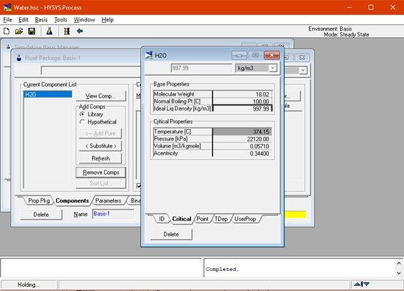

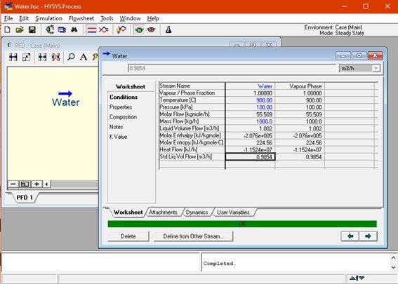

It is a fairly common mistake to think that to go from the reading of a mass flow meter to a volumetric flow, it is enough to know the density at the temperature and pressure of the reading.
First let's see how it is handled by a software, for example Hysys. It does not have a single volumetric flow, but also introduces a "Std Liq Vol Flow"
The density to use for mass to volume conversion is stored in the critical properties information of the compound.
Information about how the conversion is done in the program is on pages 55-60 of this manual:
Pages from SimBasis appendix A property packages.pdf (280.97 KiB) downloaded 1511 time(s).
For the conversion of readings in real instruments it is necessary to go to the information of the manufacturer of the instrument. Some examples on how to convert standard or actual mass to volumetric flows readings units appear in this article, highly recommended for those who don't know how to use units in process plant instrument readings.
gnan1402.pdf (1.22 MiB) downloaded 1147 time(s).

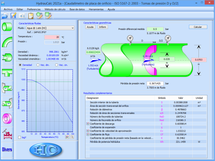

In conclusion, the only thing I see are well-managed units in all the showed calculations.
