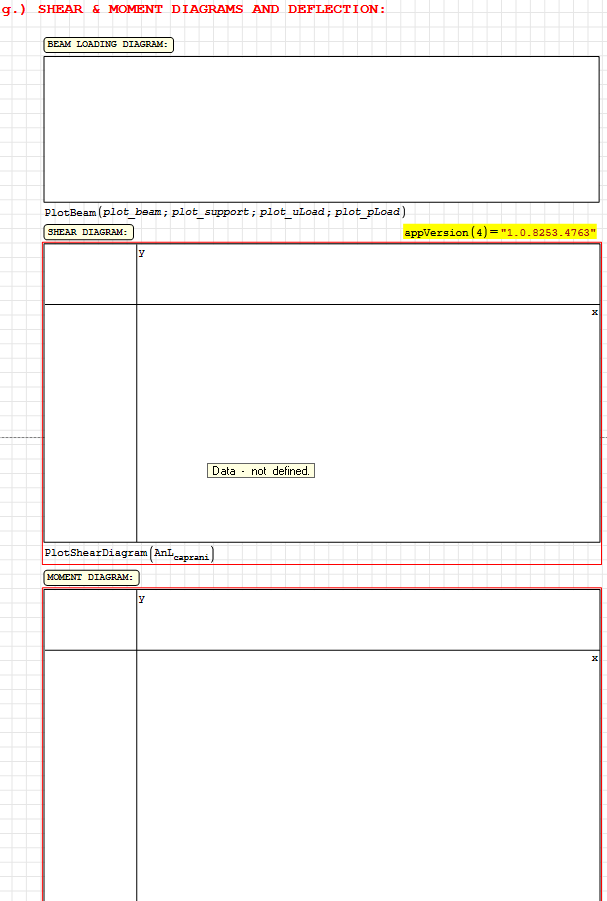

Hi everyone,
I have been using Smath for many years, but this is my first time writing to the forum
I have a problem with Structural Beam Analysis plugin. I download the Beam Analysis Input Guide from Extansions Manager and didn't change anything in the Smath file.
I couldn't figure out what is causing this situation. Do you have any idea?
Thanks in advance,

work fine for me, maybe -->
This worksheet requires that the associated Plugin (Structural Beam Analysis
Utility Functions by Redem Legaspi Jr.) be downloaded and enabled from SMath
Studio Extension Manager tool.

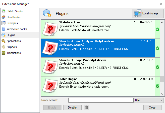

#25 Posted: 9/16/2022 10:24:58 AM
Safak
Safak
0 likes in 2 posts.
Thank you for your reply. The plugin was already enabled.

It's like there's a missing data
#27 Posted: 1/3/2023 2:56:24 PM
oli123
oli123
0 likes in 1 posts.
Hello.
Sources of Beam Analysis Utility Functions stored on SMath server but author of a plug-in asked not to share them.
Several days ago I've got permissions to fix an issue.
Could somebody help me with that?
Plug-in functionality restored now. Tested ok with all available sample worksheets.
New version of a plug-in available using Extensions Manager.
