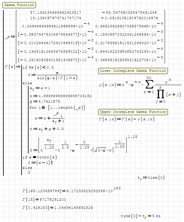

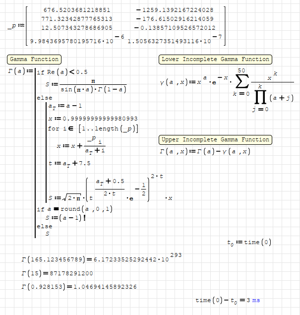

Gamma function,
Lower Incomplete Gamma function,
Upper Incomplete Gamma function,
with almost instant speed and high precision.
gamma.sm (34.69 KiB) downloaded 1431 time(s). <---- least accurate
gamma_r2.sm (11.52 KiB) downloaded 1422 time(s).
gamma_r3.sm (11.8 KiB) downloaded 1418 time(s).
gamma_r4.sm (13.82 KiB) downloaded 1419 time(s).
gamma_r5.sm (11.38 KiB) downloaded 1467 time(s).
gamma_r6.sm (17.75 KiB) downloaded 1383 time(s).
gamma_r7.sm (28.8 KiB) downloaded 1504 time(s).
gamma_r8.sm (31.51 KiB) downloaded 1529 time(s).
gamma_r9.sm (36.93 KiB) downloaded 1912 time(s). <----imaginary numbers added
#2 Posted: 6/8/2021 2:57:24 PM
600 likes in 1,381 posts.
Thanks, will explore.
Main limitation is smath floating points.
Python gives much more accurate results with same algorithms.
Try the other one for gamma calculation.

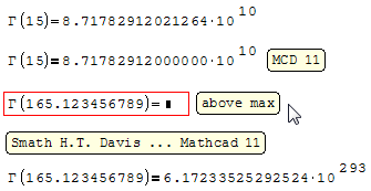

#3 Posted: 6/8/2021 7:21:30 PM
round(■ ,■ ,■ ) ... undefined
H.T.Davis [Abramowitz & Stegun] -> very objective.
In the mean time I'm finishing two superb applications examples
... examples based on your first Gamma(a,x) version,
Thanks for that one, gorgeous ... Jean.
gamma_r2 [H.T.Davis].sm (57.43 KiB) downloaded 1225 time(s).

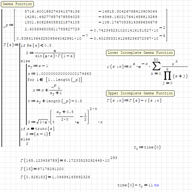

Undefined because you have an old version of smath.
Round(#,#,#) is not parsed through your program.
Use trunc() instead. And with more constants.
#5 Posted: 6/8/2021 8:34:03 PM

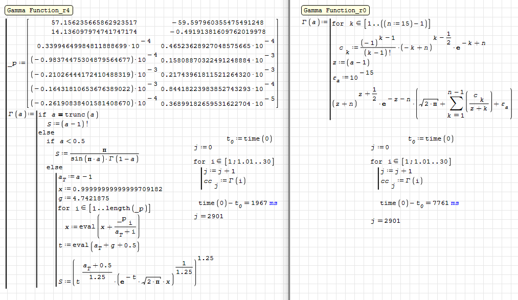

Technically this should be the most accurate one.

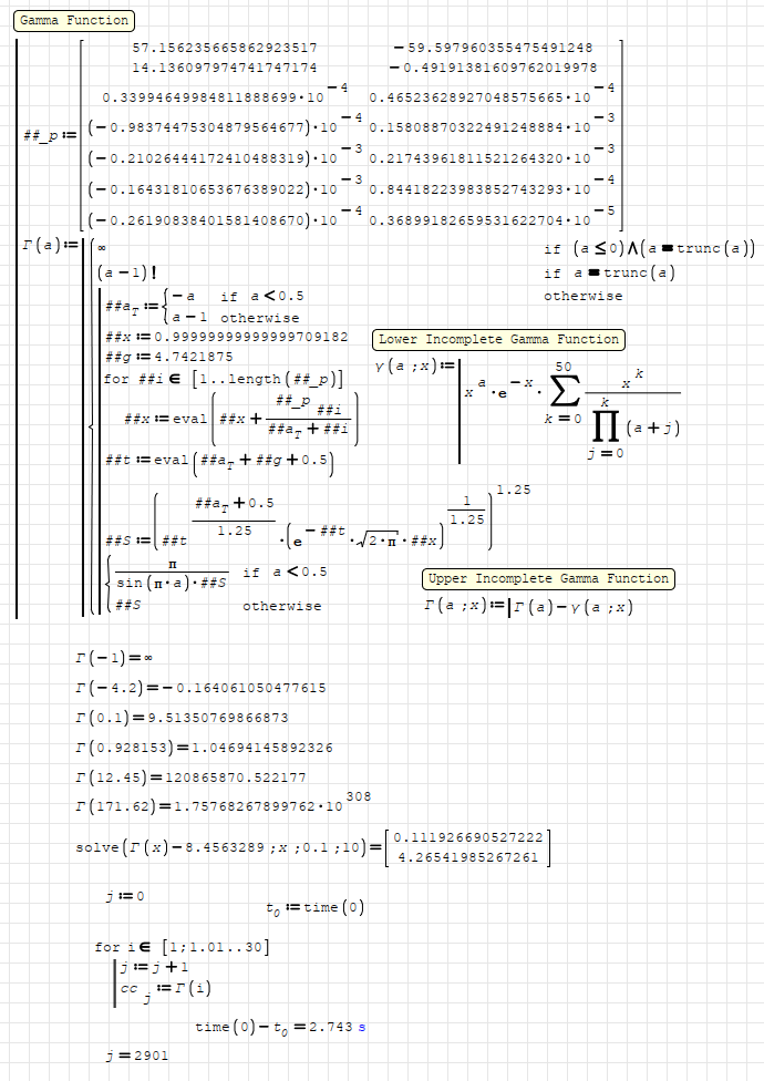

I suggest you to change gamma function with gamma_r4.
It is 3 times faster and much more precise.

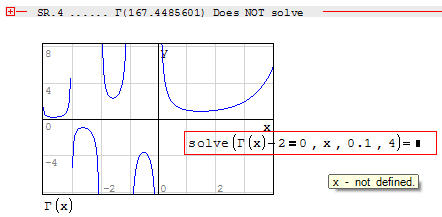

#8 Posted: 6/9/2021 1:46:58 PM
Thanks for gamma_r4
1. NO gain timing both applications
2. gamma_r4 Does NOT solve ... first version solves.
#9 Posted: 6/9/2021 2:06:13 PM
Thanks for gamma_r4
Speed may differ between linux and windows.
gamma_r4 is faster 3 times in linux.
What do you mean by 'does not solve'?
How should this page look like?

#11 Posted: 6/9/2021 2:36:55 PM
I think this is the same bug I mentioned earlier. Some functions don't like to be in another function.
Solution was to put a line but that method is not working in this case.
@Andrey or @Davide has to look at this.
#12 Posted: 6/9/2021 4:03:46 PM
Latest version is faster about 4 times.
#13 Posted: 6/9/2021 4:23:05 PM
It solves, not with conventional methods.
They tend to give errors, not gamma_r4's fault.

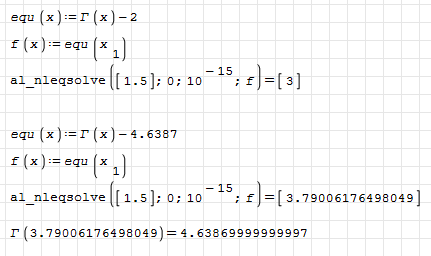

alglib is the answer, it usually gives result.
#14 Posted: 6/9/2021 9:50:11 PM
Good rescue ... OK.
As it looks, sr4 resides at the kernel level.
Thus, it plots but not solve(,,,,)
because not scalar wrt 'x' for the solve bloc.
#15 Posted: 6/9/2021 10:06:36 PM
Good rescue ... OK.
Nope, not related with kernel, blocks, scalability, etc.
It is probably a bug of solve(), roots(), FindRoot().
Gamma Function has nothing to do with it.
Even very simple ones suffer from this too.
Check below.

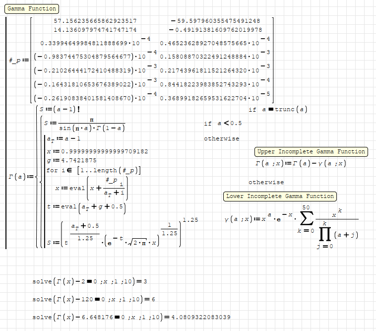

It seems solve(), roots(), FindRoot() doesn't like if statements.
I have updated the bugreport in Bugs and Problems > solve() bug.
Using cases() seems to solve the issue. Check the sample below.

#18 Posted: 6/10/2021 10:56:05 PM
gamma_r5 has a serious flaw. It can't calculate a<0.5.
My bad, should check it carefully. Corrected page is below.
Refactored so it is faster, also get rid of recursive call.
I had to get around some smath bugs with line, if/cases, recursive.
Correlation of them gives weird errors.
Hope this version solves all issues and be the last one.
I know I have flooded this topic too much, sorry for inconvenience.

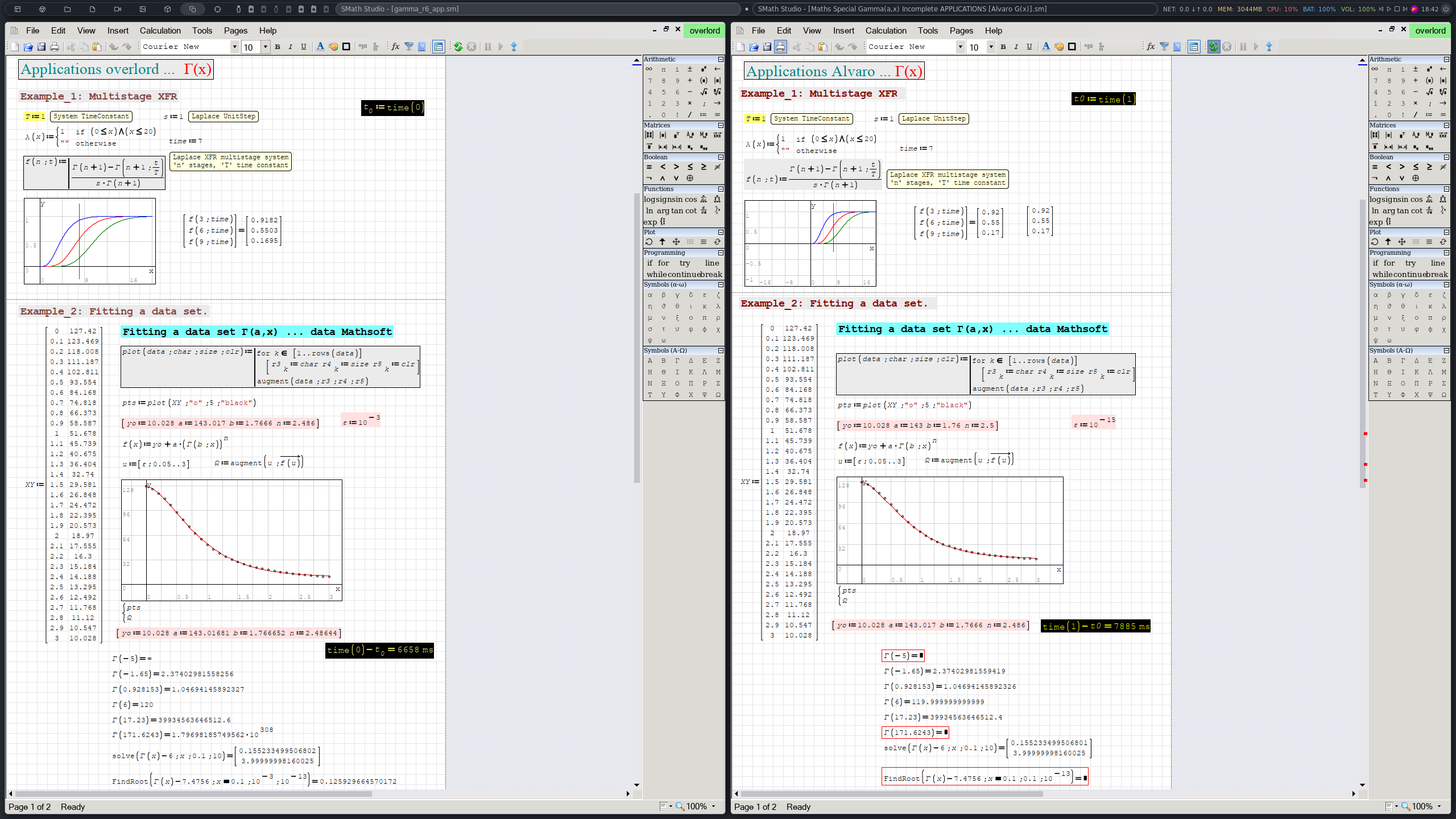

1. 10^308 feature added for fully use IEEE capability.
2. gamma_r6 runs every possible applications.
3. don't want to disrespect, Alvaro's is a single line awesome code.
4. mine has same algorithm with more features, with faster calculation.
4. gamma_r6 is faster from gamma_r2 and gamma_r3 while trying to have all feature.
gamma_r6_app.sm (33.87 KiB) downloaded 1413 time(s).
Here is a side by side comparison with Alvaro's algorithm with mine.
On linux, gamma_r6 is faster about 20 percent.
