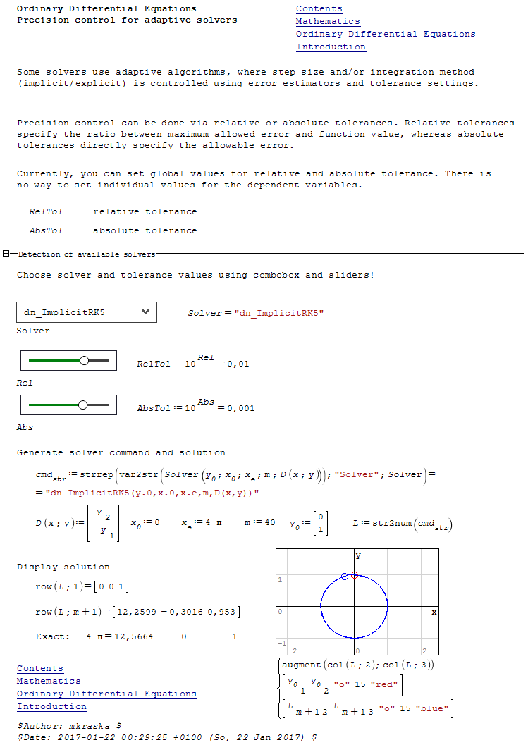

#23 Posted: 9/9/2018 2:23:36 PM
1,359 likes in 2,273 posts.
It seems that all the dotnumeric ode solver functions fail to add the last step to the solution. In the given example, the exact solution is (approximately) met if the end value of x is increased by one step (x_end/steps).
The sheet is easily extended to whatever ode solvers by adding their name to the search list. The actually available solvers depend on what plugins are installed.
Section Math ODE precision.sm (23.66 KiB) downloaded 1874 time(s).

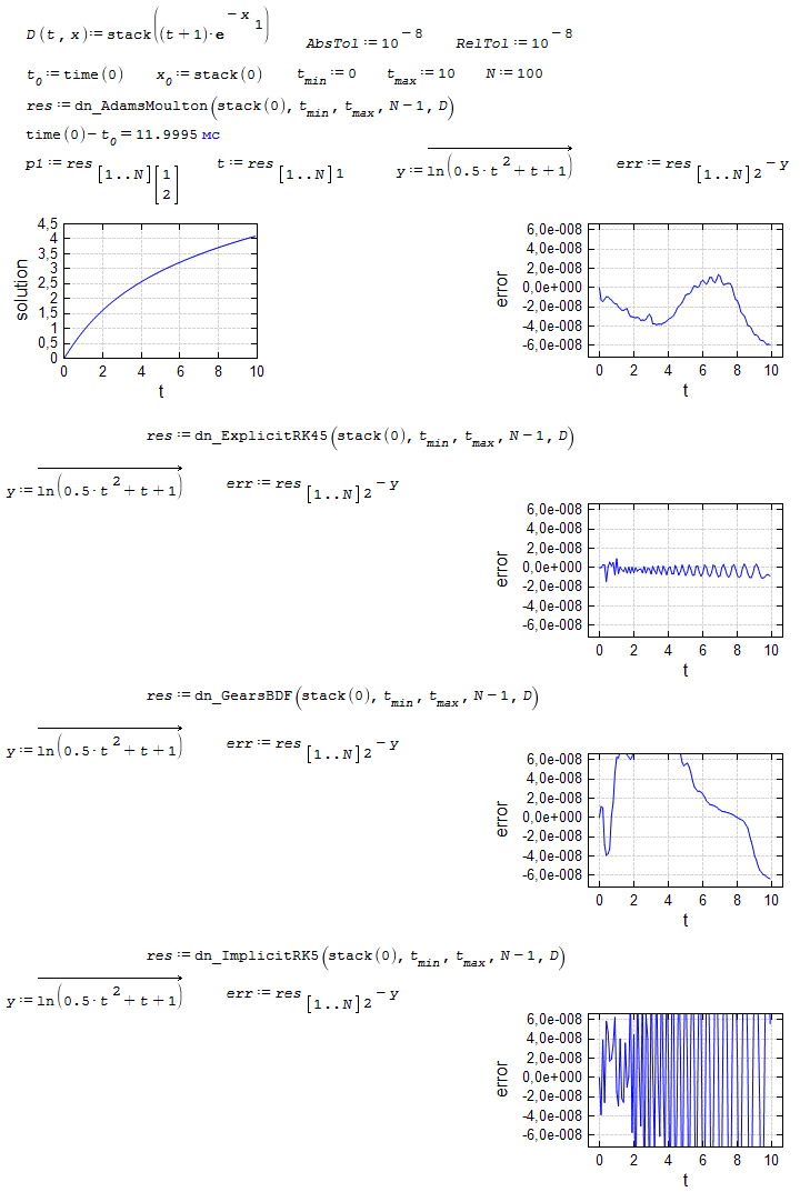

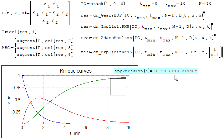

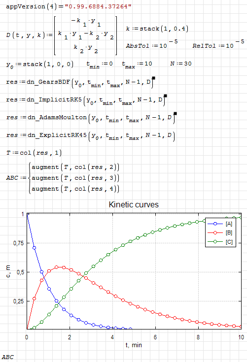

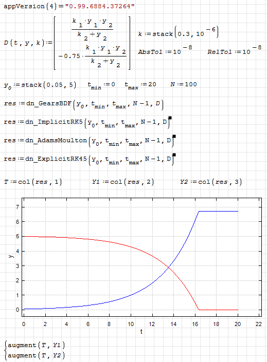

#25 Posted: 12/6/2018 2:42:53 PM
1,555 likes in 1,867 posts.
Updated.

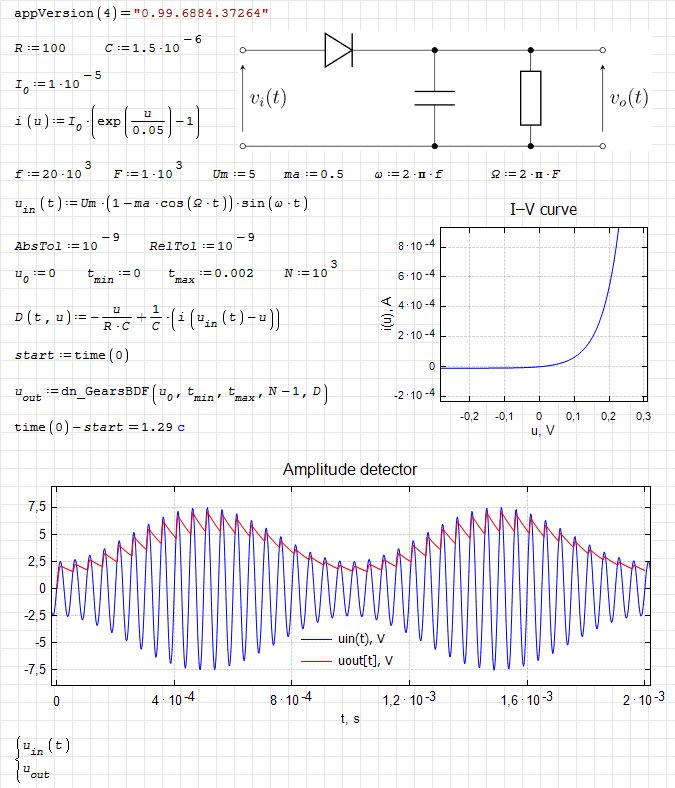

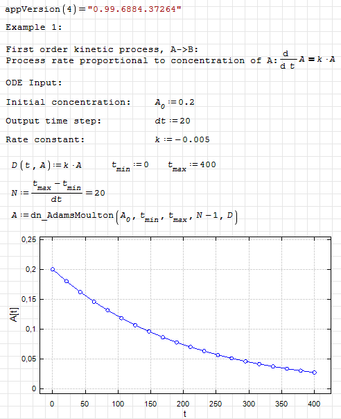

2018-12-24_17-06-48.png 2018-12-25_04-33-23.png 2018-12-25_04-34-24.png dn.ode.test2.png dn.ode.test1.png 2018-12-24_17-07-41.png
dn.ode.kinetic1.sm (8.26 KiB) downloaded 1959 time(s).
dn.ode.kinetic2.sm (12.59 KiB) downloaded 1835 time(s).
dn.ode.kinetic3.sm (12.28 KiB) downloaded 1904 time(s).
dn.ode.test1.sm (19.58 KiB) downloaded 1907 time(s).
dn.ode.test2.sm (18.88 KiB) downloaded 1897 time(s).
dn.ode.Amplitude detector.sm (20.17 KiB) downloaded 1941 time(s).
dn.ode.kinetic1.pdf (77.42 KiB) downloaded 1075 time(s).
dn.ode.kinetic2.pdf (93.05 KiB) downloaded 1004 time(s).
dn.ode.kinetic3.pdf (91.31 KiB) downloaded 989 time(s).
dn.ode.test1.pdf (115.72 KiB) downloaded 970 time(s).
dn.ode.test2.pdf (120.44 KiB) downloaded 964 time(s).
dn.ode.Amplitude detector.pdf (148.87 KiB) downloaded 1013 time(s).

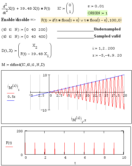

#27 Posted: 12/25/2018 2:49:08 PM
Native works as well.
You can try rkfixedSteven.

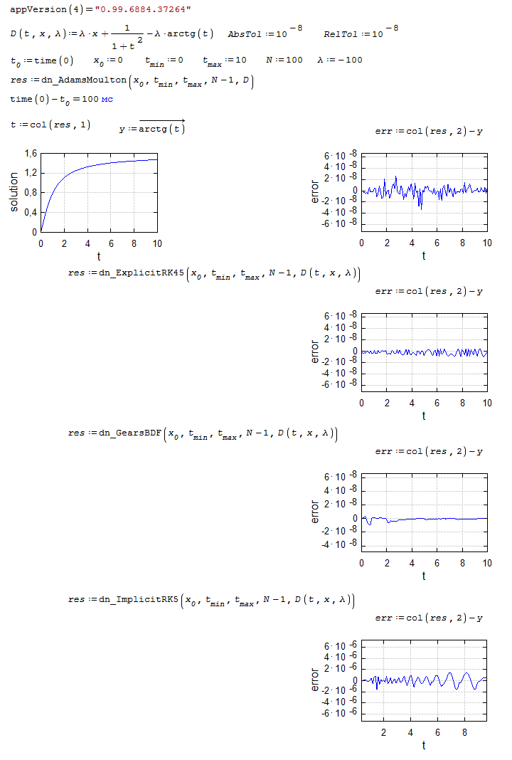

#31 Posted: 8/21/2022 2:43:28 AM
1,138 likes in 1,805 posts.
Hi Viacheslav. There are an issue with Implicit and dn_ExplicitRK45, just in the first element. Please see the attached.
dn_ExplicitRK45 issue.sm (8.42 KiB) downloaded 1722 time(s).
Вячеслав Мезенцев 8/22/2022 3:11:00 AM
#32 Posted: 8/22/2022 3:12:45 AM
SMath Studio compatibility
Plugin updated.
Changes:
- fixed values of initial conditions in the output array for dn_ImplicitRK5() and dn_ExplicitRK45().
