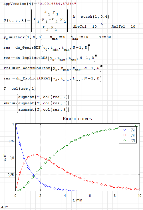

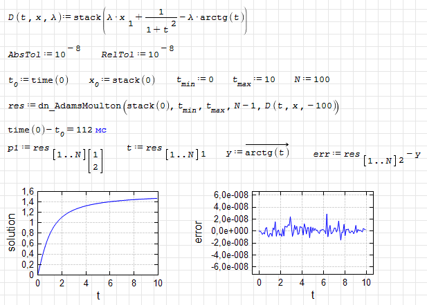

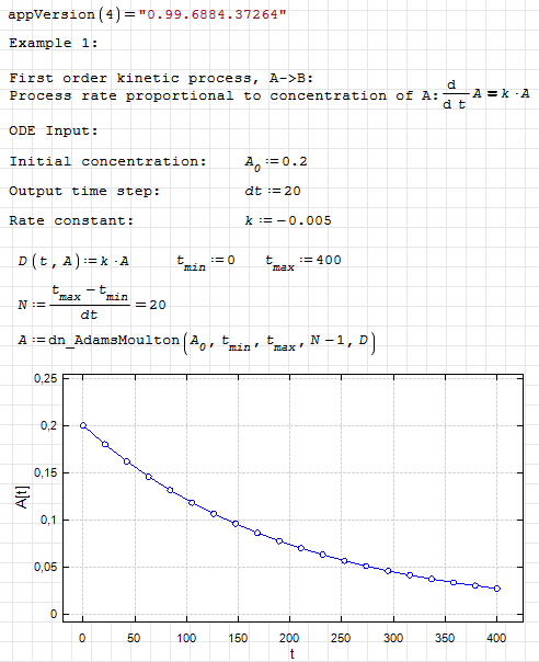

Test_GearsBDF.png DotNumerics. Example 3.png DotNumerics. Example 4.png Arenstorf orbit.JPG

Updated. I've added support for accuracy (not completely). The library allows to set accuracy for each equation separately. Now for all the equations will be the same accuracy.

Yes ... This was simply great and a celebration for my eyes and soul .

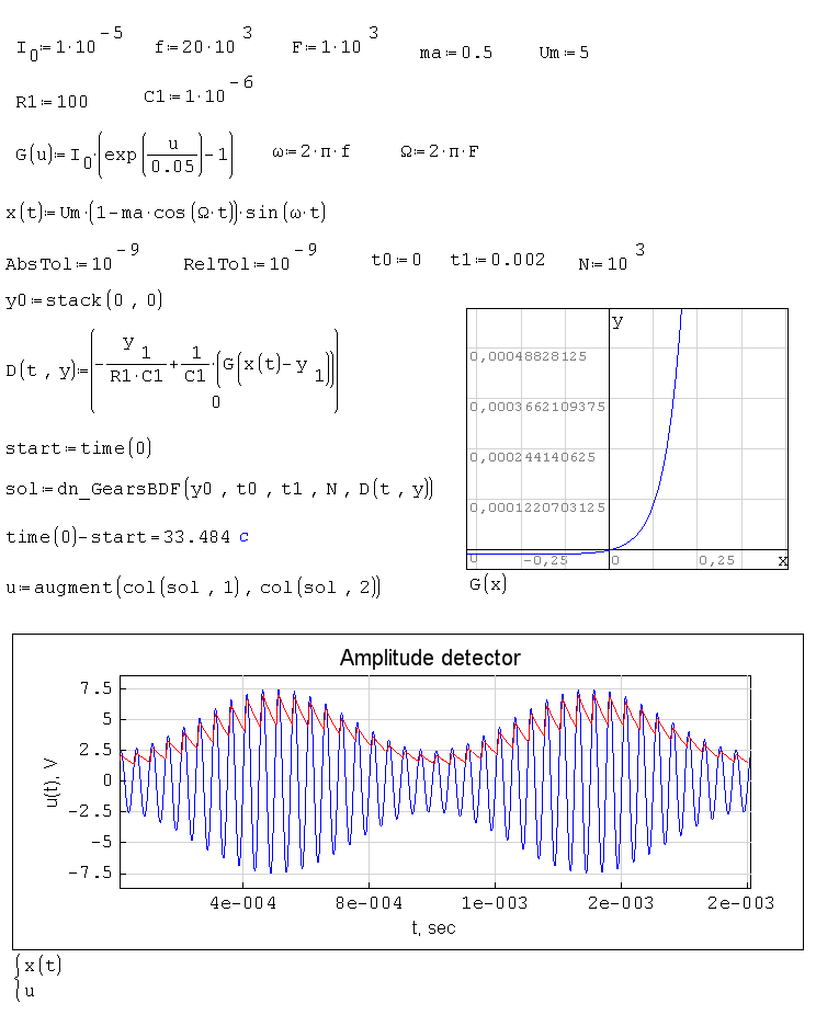

Amplitude detector.
Amplitude detector.sm (14.41 KiB) downloaded 1737 time(s).
