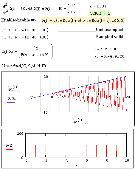

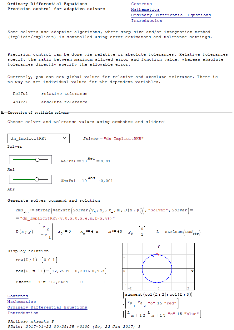

#23 Опубликовано: 09.09.2018 14:23:36
It seems that all the dotnumeric ode solver functions fail to add the last step to the solution. In the given example, the exact solution is (approximately) met if the end value of x is increased by one step (x_end/steps).
The sheet is easily extended to whatever ode solvers by adding their name to the search list. The actually available solvers depend on what plugins are installed.
Section Math ODE precision.sm (23,66 КиБ) скачан 1916 раз(а).

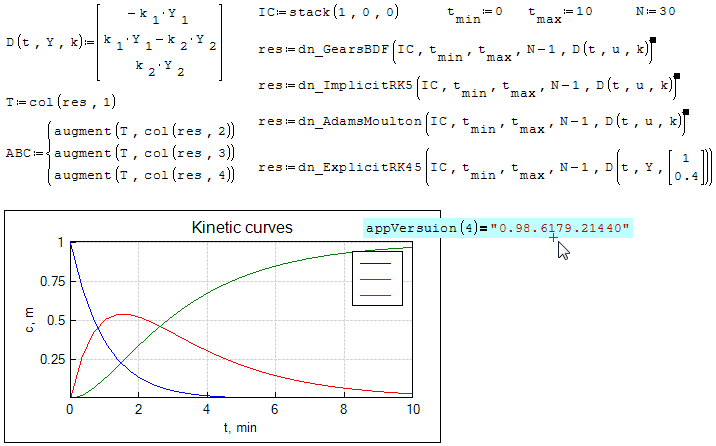

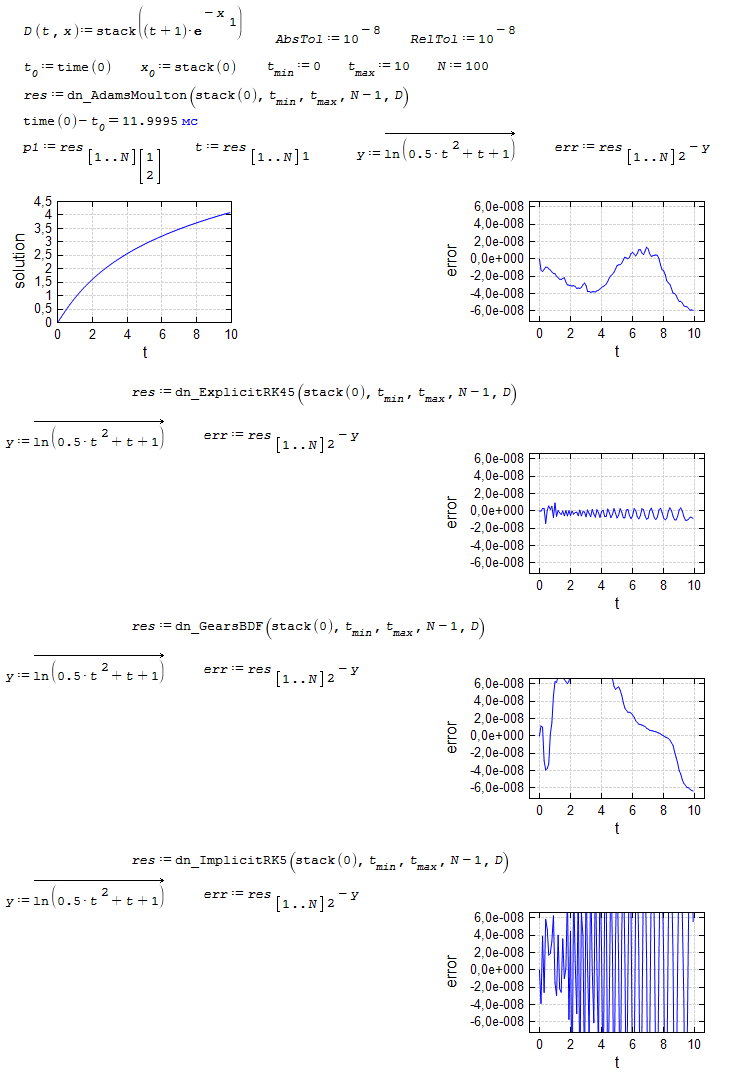

#26 Опубликовано: 24.12.2018 09:13:53
Updated.
2018-12-24_17-06-48.png 2018-12-25_04-33-23.png 2018-12-25_04-34-24.png dn.ode.test2.png dn.ode.test1.png 2018-12-24_17-07-41.png
dn.ode.kinetic1.sm (8,26 КиБ) скачан 2015 раз(а).
dn.ode.kinetic2.sm (12,59 КиБ) скачан 1883 раз(а).
dn.ode.kinetic3.sm (12,28 КиБ) скачан 1957 раз(а).
dn.ode.test1.sm (19,58 КиБ) скачан 1958 раз(а).
dn.ode.test2.sm (18,88 КиБ) скачан 1939 раз(а).

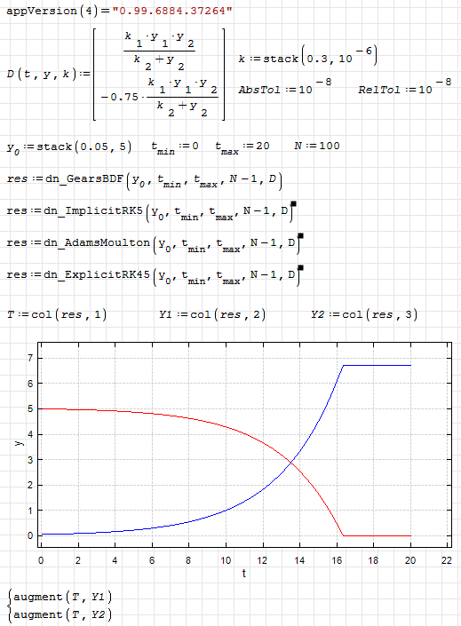

#31 Опубликовано: 21.08.2022 02:43:28
Hi Viacheslav. There are an issue with Implicit and dn_ExplicitRK45, just in the first element. Please see the attached.
dn_ExplicitRK45 issue.sm (8,42 КиБ) скачан 1768 раз(а).
#32 Опубликовано: 22.08.2022 03:12:45
SMath Studio compatibility
Plugin updated.
Changes:
- fixed values of initial conditions in the output array for dn_ImplicitRK5() and dn_ExplicitRK45().
