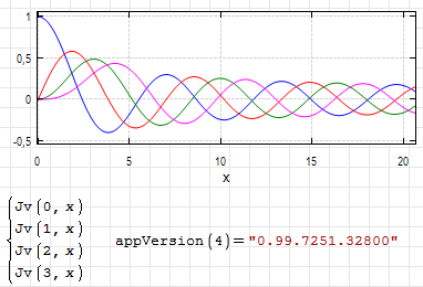

Please help!
Program version 0.99
Installed the Userefi extension
Bessel functions don't work.
Copied mathlib.dll in \Application Data\Match\extensions\plugins\91a20d24-c30b-4774-9b1b-4d502a80420f\1.0.7165.40625\userefi
The Bessel functions don't work anyway.
How do I make them work?
#26 Posted: 5/12/2020 7:52:17 AM
1,558 likes in 1,868 posts.
All functions from the mathlib.dll library you can find in Cephes Math Library.
Все функции из библиотеки mathlib.dll содержатся в дополнении Cephes Math Library.
#27 Posted: 5/12/2020 8:20:20 AM
These 4 [J,Y]
Bessel JY.sm (85.01 KiB) downloaded 1206 time(s).
#28 Posted: 5/12/2020 8:40:51 AM
sashkin_kot
sashkin_kot
0 likes in 2 posts.
Thanks, it seems to work!
