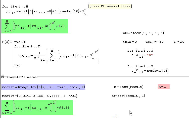

20 points (~24 sec). I made some little changes in Draghilev() function.
Draghilev's method. NLS. Example 2.smz (6.17 KiB) downloaded 1321 time(s).
Radovan Omorjan 10/6/2012 10:41:00 AM

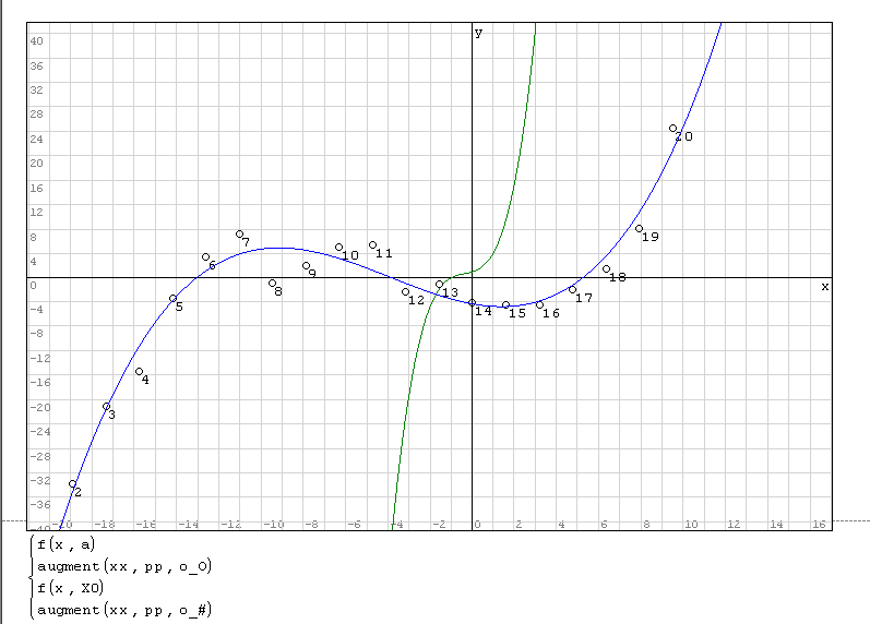

#26 Posted: 10/6/2012 11:02:10 AM
Hello uni,
It is quite interesting that you've made it working with 20 points .
By the way, I've added the sum of squares - just to check how this sum reduces its value.
Вячеслав Мезенцев 10/6/2012 11:12:00 AM

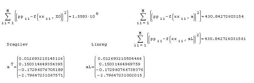

#31 Posted: 10/7/2012 6:20:29 AM
Hello uni,
It seems very promising
As it is basically a linear regression over parameters (polynomial equation) I just added the result of it - just for checking. The results are very close to each other. It is interesting that the method is working on this problem very well
The determinant [MATH=eng]det((transpose(XX)*XX))=2.40082615642816*10^16[/MATH]is rather far from zero - well conditioned system. I suppose that would be very interesting to see what will happen when this determinant is quite close to zero - ill conditioned system. I suppose that the results must be quite different.
Вячеслав Мезенцев 10/7/2012 6:35:00 AM

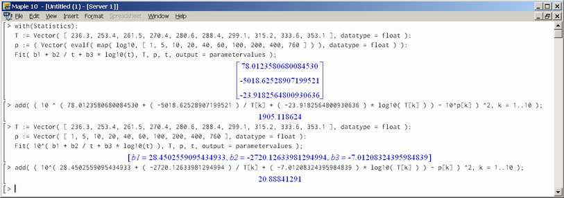

Radovan, it's really hard to get a solution using the Draghilev method. I do not know how to do it yet.
The solution here is: [28.4502559095434933, -2720.12633981294994, -7.01208324395984839]. Maybe later I'll be able to get it.

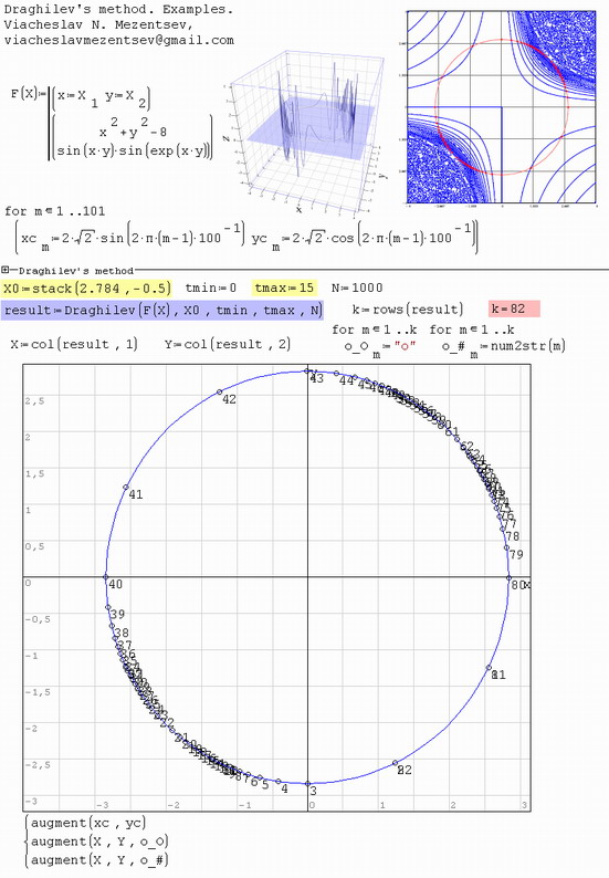

Example 5. Finding roots: System 4.
[MATH]sys(x^2+y^2-8=0;sin(x*y)*sin(exp(x*y))=0;2;1)[/MATH]
I made minor changes to simplify the calculations. Function has become more clear.
Calculation time: ~1.5 min
Roots: 80
Radovan Omorjan 10/11/2012 2:36:00 AM
