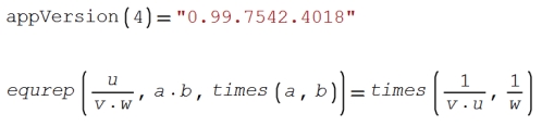

"equrep() function supports variables/functions replacements now."
Any example about what that means?

Also, I see that this error persists:
Yes, this is a main reason why I can't release stable version of SMath Studio now. I'm working on this issue right now.
Any example about what that means ?
Can you show an application of it ?
An image is good enough.
Thanks ... Jean
Hi Jean. Here: Applications for equrep: expression isolation and laplace transform.

Hi. Thanks! Very much!
I post that question because interpret that then equrep works replacing f by sin in this example: "equrep(3+f(x),f,sin)=3+f(x)" but now I see that the correct way is "equrep(3+f(x),f(a),sin(a))=3+sin(x)"
