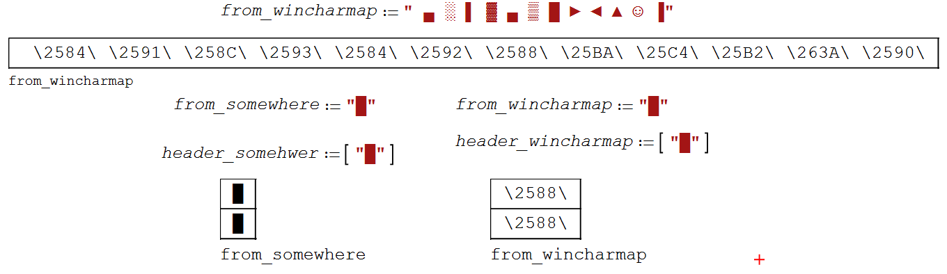

Thanks for the tip, Jean, but it is not working either.
I compare the behaviour of a █ symbol a got somehwere in the internet versus the one provided by win charmap and get the following:
By the way, both SMath and Table Region are updated.
#102 Posted: 8/24/2020 11:10:29 AM
I dropped dead on that !
Try the native SS 6179 work sheet.

#103 Posted: 8/24/2020 11:39:37 AM
1. WinCharmap ... TT OpenSymbol [TT = True Type]
2. Browse the symbol/select ... it shows in the line
3. Copy/paste in header "paste in there"
4. Nothing shows ... Ah !
5. Paste then type 1 it shows symbol ... backspace 1
6. Now you just have symbol
7. You can accumulate symbols in the select/copy line
8. Browse/select, browse/select ...
9. Copy, paste in header for all those symbols
10. Like before: paste, type 1 ... backspace 1
#104 Posted: 8/29/2020 12:24:26 PM
João Felipe Seráfico Melo
7 likes in 62 posts.
Sorry for the delay in replying. It still doesn't work.

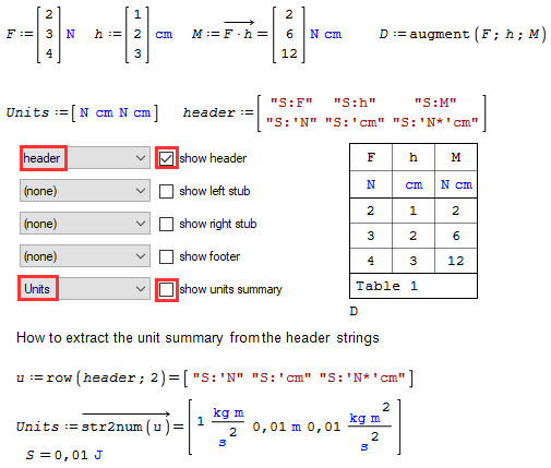

#111 Posted: 8/9/2023 8:17:25 PM
1,361 likes in 2,275 posts.
Feature request:
I propose to allow the units summary to accept also vectors of string-coded units (as used in the header)
Benefit:
- Display of the unit summary would be possible with nice pretty printing
- Guaranteed consistency between units applied to the data and displayed units.
In fact, it would be best to avoid encoding and to dirctly specify the units. Yet that seems to be impossible as long as the storage is only in base units.
The example below shows how to extract a valid unit summary out of a header with string-coded units.
Tableunits.sm (18.42 KiB) downloaded 1831 time(s).
