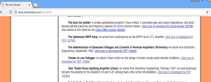

Registration is not required on the page. The file can be downloaded directly from:
salutări

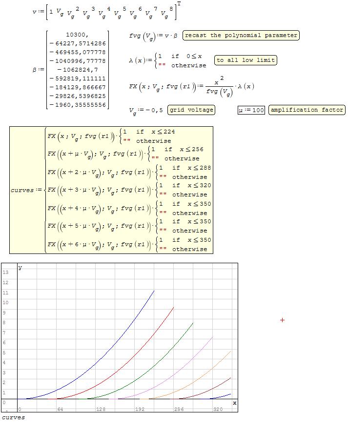

I believe that the function should be something similar to what I show here.
This attempt is only an idea, where the equation only depends on the value Ua and Ug.
Tesla_Origen_CBG_Jean.sm (122.3 KiB) downloaded 1223 time(s).
regards
Carlos

Carlos: does it make sense to recast with more flexibility [typical] ?
Project Tesla_Origen_CBG_Jean.sm (137.12 KiB) downloaded 1223 time(s).

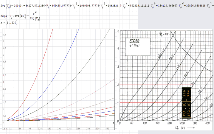

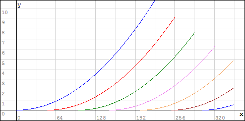

I do not know what "r1" is in Carlos's relationship. And then what I see does not correspond visually to the diagrams in the datasheet.
... And what about the first curve?
Nicolas
#48 Posted: 6/18/2018 5:27:23 PM
1. The parameter 'r1' is not accounted ... removed
2. This is experimental from observed ... your data set is phenomenological.
So, they don't relate. You had the XFR phenomenological from before.
3. "first curve" is not experimental ... a fake one added.
Project Tesla_Origen_CBG_Jean [Refactored].sm (11.72 KiB) downloaded 1049 time(s).

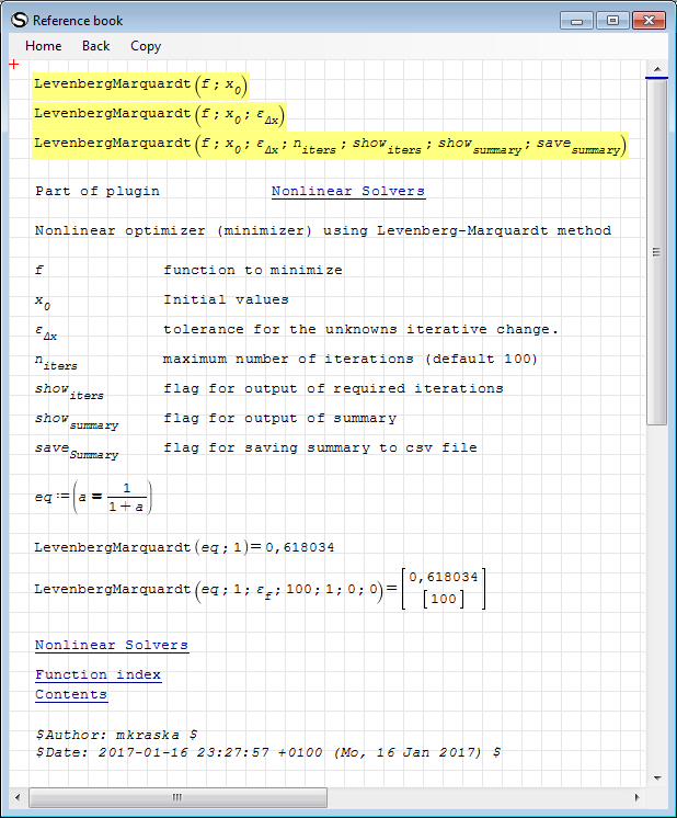

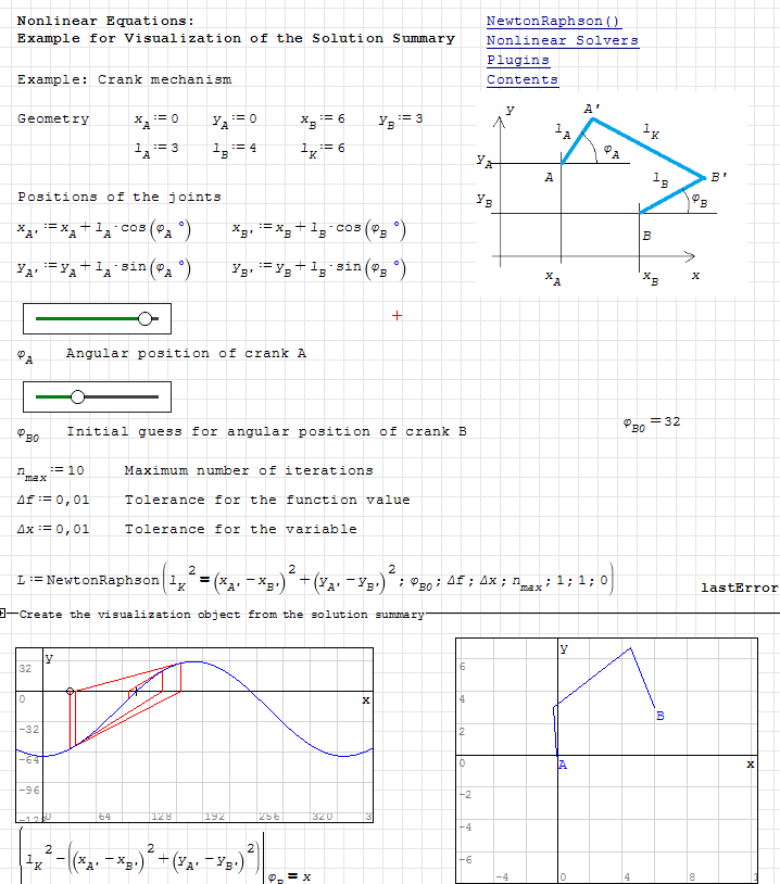

The Levenberg-Marquardt method can be (I hope) closely related to solving the non-linear equation system that interests me. In SMath, however, there are seven different variants of the Levenberg-Marquardt method. I think I understand what it is about LevenbergMarquardt (2) and LevenbergMarquardt (3). I ask someone to explain what are the input sizes for the variants: LevenbergMarquardt (7); LevenbergMarquardtCD (2); LevenbergMarquardtCD (3); LevenbergMarquardtCD (4) and LevenbergMarquardtCD (8). Small examples of application would be very useful. All the best.

#52 Posted: 6/26/2018 7:12:22 PM
1,361 likes in 2,275 posts.
Hello everybody
Nicolas
Try the interactive handbook.
Goto Functions Index, open the L area and Ctrl-Click to LevenbergMarquardt(). In the Nonlinear Solvers page you find a link on how to visualize the solution history.

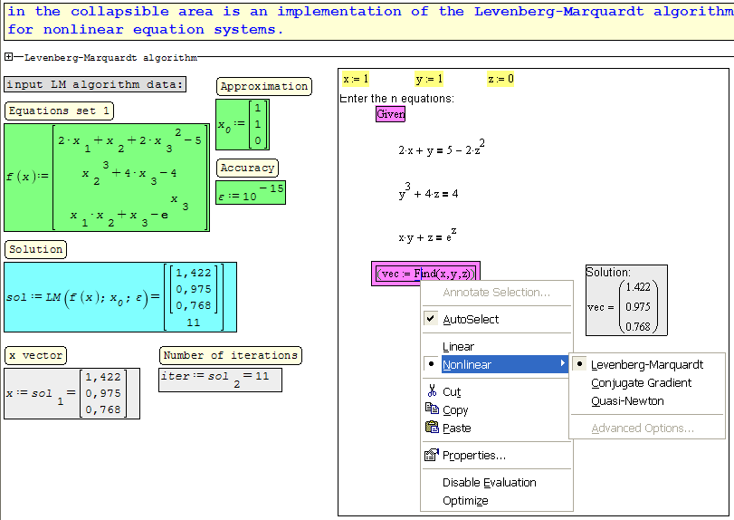

I have tried to write an algorithm in SMath to solve systems with several equations. In the attachment I have illustrated how with this algorithm I managed to solve the equation system given as an example in QuickSheets in MathCAD. I also provided the SMath file in the second attachment. Using the same algorithm I then tried to solve the problem defined in message # 1 of this topic - see the SMath file in attachment 3. After 7 iterations, the loop while from the algorithm comprised in the collapsible area became an infinite loop because size Δp has an error and the program perceives it as indefinite, although calculated separately the right member of the equation that on Δp has a finite value. I have set the spreadsheet for this file without using automatic calculation, because the higher the computing time, the computer's system memory resources are becoming less and less programmatic and the program tends to block the system. In program, the mm size set to mm = 1 corresponds to a current expressed in mA, while set to mm = 0.001 resulting streams will be scaled to Amps. To run the file, use the "Recalculate page" command in the "Calculation" toolbar, after which it will stop running after the first 20 ... 30 minutes. As the personal observations I could make, the variable vector does not change locally after 7 iterations, and the damping factor μ has a value very close to zero. Not being very experienced in such algorithms, I can not figure out where the wrong is. Perhaps the others will try to solve with me such a problem, which they will take as a challenge. Otherwise, good luck to everyone.
Nicolas
About Levenberg-Marquardt algorithm.sm (44.36 KiB) downloaded 1197 time(s).
About Levenberg-Marquardt algorithm_.sm (58.82 KiB) downloaded 1243 time(s).

Unfortunately, numerically solving the system of more than few nonlinear equations is quite a problematic thing to do in SMath. After all these years I think this is one of the thing that will never be resolved in SMath in an efficient way.
#56 Posted: 7/5/2018 8:01:34 PM
Modifications to the Levenberg-Marquardt Method
To make the Levenberg-Marquardt method more effective on actual problems, Mathcad includes the following modifications to the basic method:
The first time the solver stops at a point that is not a solution, Mathcad adds a small random amount to all the variables and tries again. This helps avoid getting stuck in local minima and other points from which there is no preferred direction. Mathcad does this only once per solve, the first time the solver stops on a point that is not a solution.
If you include inequality constraints in a solve block, Mathcad solves the subsystem consisting of only
the inequalities first before adding in the in the equality constraints and attempting a full solution.
This is equivalent to moving the guesses into an area where the inequalities are all satisfied before
starting the solver.
Solve GivenFind MCD Example.sm (10.75 KiB) downloaded 1182 time(s).
