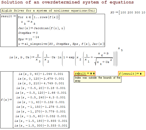

Nicolae Olaru
Nicolae Olaru
1 likes in 115 posts.
Hello.
However, AlgLib Solver works faster and depends little on X0 matrix.See # 29
https://en.smath.info/forum/yaf_topics32_Extensions.aspx
Overdetermined.sm (15.26 KiB) downloaded 1296 time(s).
I'm sorry, but again I have problems using this type of algorithm - see the attached image.
#125 Posted: 7/26/2018 5:30:25 PM
Just open and run my latest work sheet, posted today.
If you run 6671, your al_nleqsolve(,,,) needs be updated as well.
"Out of index..." => too many equalities wrt parameters.

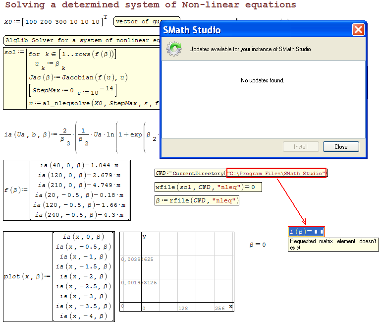

#126 Posted: 7/28/2018 3:56:42 AM
Nicolae Olaru
Nicolae Olaru
Hello.
There are no updates for my 6671. For my SMath directory, I still have errors.
Nicolas
#127 Posted: 7/28/2018 8:07:01 AM
My Smath is as well in C:\Program
But all the work sheets are in C:\Smath 6179
Where you have all your Smath work sheets, add a New Folder,
name it "SmathFile" [typical or else]
address CWD:=CurrentDirectory(......)

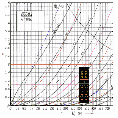

#131 Posted: 8/1/2018 11:45:39 PM
CBG
CBG
78 likes in 312 posts.
I believe that the function:
does not exactly represent the values of the Triode ECC83 graph (Tesla Graph).
Here is a comparison:
Levenberg_Marquardt_Code_CBG_Jean_Tesla_Test.sm (1.45 MiB) downloaded 1364 time(s).
Carlos
#132 Posted: 8/2/2018 11:27:15 AM
Quite right, Carlos.
The proposed function fails to fit the data sets.
Tentatively, al_nleqsolve and Levenberg-Marquardt do find a set of parameters.
As applied to fit all curves, then do not fit .
If there is an eventual compatibility, the problem is to initialize.
I tried quite a few with the most robust al_nleqsolve, not to avail.
Of all the models that were tried, I have conserved the 2 constants + 2 parameters
Genfit Minimize Tesla(5) Auto_Iterate
No matter how much maths one can invent, it is not true an invented 6 parameters
will fit 8 data sets each having his own set of 2 parameters. If such miraculous
maths would exist, I bet it would have been explored/exploited in Mathcad/Mathsoft.
Solve al_nleqsolve Ber7_Nicolas Copy.sm (55.14 KiB) downloaded 1264 time(s).
Genfit Minimize Tesla(5) Auto_Iterate.sm (238.11 KiB) downloaded 1327 time(s).
Page2 Tesla.sm (178.4 KiB) downloaded 1538 time(s).

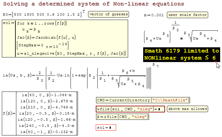

#134 Posted: 8/3/2018 4:25:33 PM
Jean Giraud is not right. MatCAD has solved the problem, so mathematical tools exist.
OK, Nicolas ... then plot the fitted family of results over the data sets.
Or, attach enough information so that I can spare some times in Mathcad 11.
This is paramount wrt Smath designers, especially from so much efforts.
Cheers Nicolas ... Jean
#135 Posted: 8/4/2018 1:21:47 PM
1. Checked the Mathcad 7 param model is same in Smath
2. if so => run that 7 parameters in attached document.
3. if it solves => attach in forum so it can be tried
Solve al_nleqsolve Ber7_Nicolas [6671].sm (21.11 KiB) downloaded 1131 time(s).
