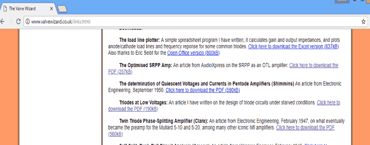

Hola Carlos
To have access to the file you have linked to, you must become a member of that forum. I have almost a horror of forums. With the exception of SMath Studio Forum, which I have enrolled to benefit from the advice of the users of this CAD program, I am only a member of two forums. One of them (where I have been a moderator for nearly 6 years) posts less and less because of the exacerbat radicalism of many of its members. The other, with fewer members, does not yet have this phenomenon and participates in discussions, but mostly publicly various technical articles. To one of these articles, you have a link in a previous post.

Registration is not required on the page. The file can be downloaded directly from:
salutări

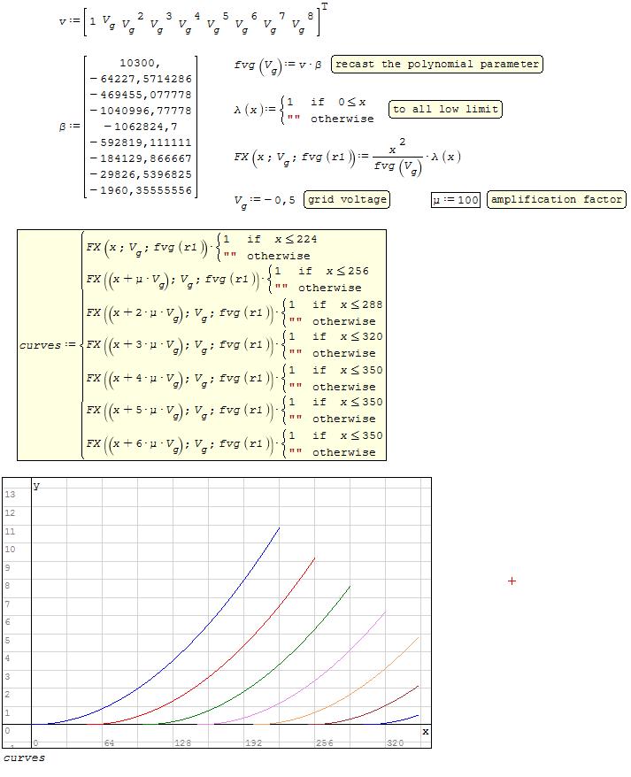

I believe that the function should be something similar to what I show here.
This attempt is only an idea, where the equation only depends on the value Ua and Ug.
Tesla_Origen_CBG_Jean.sm (122,3 КиБ) скачан 1223 раз(а).

#44 Опубликовано: 17.06.2018 11:45:00
Nicolae Olaru

I see that now the link posted by Carlos to message # 39 has been opened. But there is a list of links. Which one leads to the excel document? ...
... It's okay, I found it.
#45 Опубликовано: 17.06.2018 14:04:52

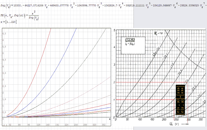

I do not know what "r1" is in Carlos's relationship. And then what I see does not correspond visually to the diagrams in the datasheet.
... And what about the first curve?
Nicolas
#48 Опубликовано: 18.06.2018 17:27:23
1. The parameter 'r1' is not accounted ... removed
2. This is experimental from observed ... your data set is phenomenological.
So, they don't relate. You had the XFR phenomenological from before.
3. "first curve" is not experimental ... a fake one added.
Project Tesla_Origen_CBG_Jean [Refactored].sm (11,72 КиБ) скачан 1049 раз(а).

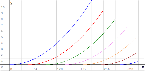

Very good. Let's say that in the file attached to you, we have the desired shape of the curves. Basically, I only got a beam of curves similar to those in the datasheet. How do I now define the unique function that will generate for each pair of Va and Vg variables the Static Operating Point (SOP)? I do not really need a picture of the characteristic curves, but a relationship that generates for each couple of input data a single SOP in the voltage-current plane. In other words, we look at the variable Vg as one that takes values in a continuous domain, and not a sequence of predetermined values. As I have already mentioned, the mathematical model is going to be useful in a simulation program.

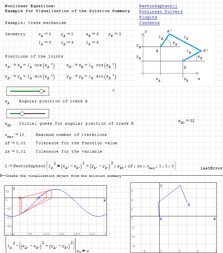

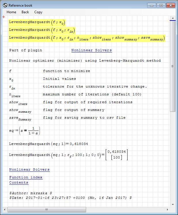

Try the interactive handbook.
Goto Functions Index, open the L area and Ctrl-Click to LevenbergMarquardt(). In the Nonlinear Solvers page you find a link on how to visualize the solution history.
bdrunagle 27.06.2018 04:00:00, frapuano 26.06.2018 19:16:00

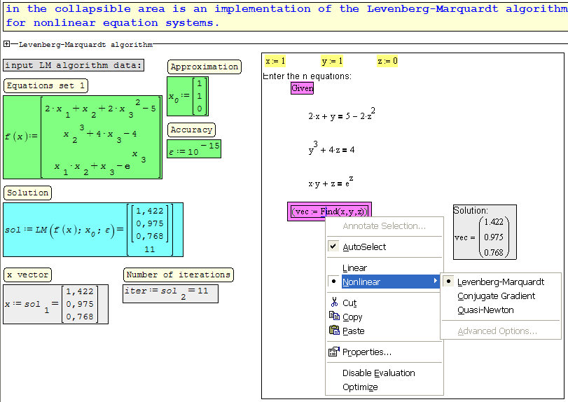

I have tried to write an algorithm in SMath to solve systems with several equations. In the attachment I have illustrated how with this algorithm I managed to solve the equation system given as an example in QuickSheets in MathCAD. I also provided the SMath file in the second attachment. Using the same algorithm I then tried to solve the problem defined in message # 1 of this topic - see the SMath file in attachment 3. After 7 iterations, the loop while from the algorithm comprised in the collapsible area became an infinite loop because size Δp has an error and the program perceives it as indefinite, although calculated separately the right member of the equation that on Δp has a finite value. I have set the spreadsheet for this file without using automatic calculation, because the higher the computing time, the computer's system memory resources are becoming less and less programmatic and the program tends to block the system. In program, the mm size set to mm = 1 corresponds to a current expressed in mA, while set to mm = 0.001 resulting streams will be scaled to Amps. To run the file, use the "Recalculate page" command in the "Calculation" toolbar, after which it will stop running after the first 20 ... 30 minutes. As the personal observations I could make, the variable vector does not change locally after 7 iterations, and the damping factor μ has a value very close to zero. Not being very experienced in such algorithms, I can not figure out where the wrong is. Perhaps the others will try to solve with me such a problem, which they will take as a challenge. Otherwise, good luck to everyone.
Nicolas
About Levenberg-Marquardt algorithm.sm (44,36 КиБ) скачан 1197 раз(а).
About Levenberg-Marquardt algorithm_.sm (58,82 КиБ) скачан 1243 раз(а).
