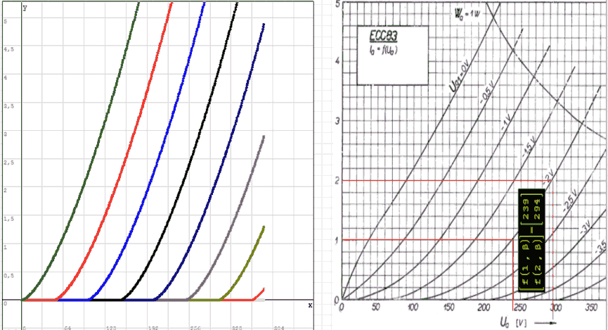

Thanks CBG for interest and involvement. As I have already said, a domain-defined function is not useful, since these domains can not be specified through the script that puts this function into a specific simulation program, such as Multisim - for example. For this reason, a single function must be defined to be continuous and derivative on the intervals -4
#22 Posted: 6/3/2018 8:32:19 PM
a domain-defined function is not useful, since these domains can not be specified through the script that puts this function into a specific simulation program, such as Multisim.
If Multisim can't take a mathematical expression from Smath or else ... what can you do?
Just recycle Multisim because as you say it is not a math tool, just a gadget.
Maybe it can take the plot [te 9 plots in sequence] of your Tesla.
1. Those plots, you have them from Carlos and I offer from more compacted polynomial fit.
2. Those plots, you have them as from the "x*ln(1+exp(Ug/x)) , which basically the function
you attempted in your Mathcad that failed miserably.
3. Both proposals [Carlos, Jean] are smooth, monotonous, continuously derivable/integrable.
Don't neglect understanding the note:
"The polynomial fit tends to fit as well the defective digitized data.
Digitized data are inaccurate by themselves and more inaccurate from
the french curve spline creator from not true analog experiment in
the original Tesla lab work."
In short: Smath recovers your TESLA [1959].
Multisim is left to be coded to read either maths or Smath graphs
Genfit Minimize TESLA RECONCILIATION.sm (389.53 KiB) downloaded 1156 time(s).

Thank you very much Jean for your accurate response.
HOLA Ola_Nicolas!!!
What I did, was simply find the equation that represents each curve
of the given graph. The functions are continuous, but when representing
a polynomial of 4 degree, they are unstable outside the specified ranges.
On the other hand, doing a little research, I found that the curves of
the TESLA graph were constructed with the equations of Scott Reynolds
and Marshall Leachfon, or with the improved equations of Normal L. Koren.
The plate current equation for triodes is
IP = (EG + EP /� )^3/2 / kG1 for (EG + EP /� > = 0
= 0 otherwise.
The plate current equation for pentodes is
IP = (2 / kG1p) (EG + EG2 /� )^3/2 arctan (EP / kV for EG + EG2 /� > = 0
= 0 otherwise.
� is the amplification factor
Unfortunately, these equations also contain a decision.
Here I leave the information link, which I hope will be of interest and help to you.
http://www.normankoren.com/Audio/Tubemodspice_article.html#Platecurves
Here is a small attempt to graph the curves with the formulas indicated above.
Tesla_CBG_R1.sm (137.44 KiB) downloaded 1149 time(s).

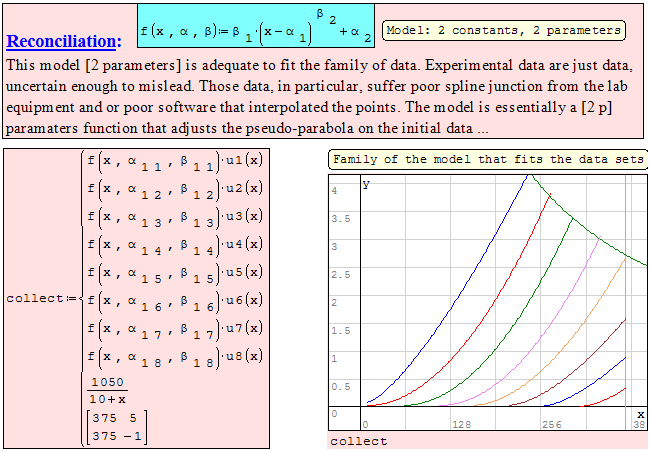

#34 Posted: 6/11/2018 12:27:02 PM
IMHO =
... this model should solve all curves.
It solves/iterates nicely for this particular data set.
f(x,β) recovers from the reduced solving procedure.
Genfit Minimze Tesla.sm (45.6 KiB) downloaded 1185 time(s).

#37 Posted: 6/13/2018 8:12:55 PM
I'm just trying to do it. Otherwise today there are all kinds of complex electronic devices for automatic drawing of the curves characteristic of the triodes and the pentodes.
Ok ... Savant gadgets are just gadgets, proof: the one you have used has muffed
your lab test. L. Koren equation is phenomenological as it says. Unfortunately,
experimental data are not exactly reproducible. Nothing in the circuitry is
reproducible not even the triode/pentode ... think of similar physics wrt T/C
T/C = Thermocouples. In short, the Creator was short of fully understanding what
He was creating.
Your complex attempted formulation does not speak to me.
The attached proposal fits your data sets based on 2 parameters and 2 fixed constants.
The constants are the initials X, Y of each experiment. It needs only two parameters
for each experiment. The model function is not suitable for auto-iterate ... peanut
work to calculate trial/error.
If possible, it would be interesting your collect ~ 20 points, raw ... as measured
with good equipment. No processing, no spline curve junction.
Salut Nicolas, will read you soon ... Jean
Genfit Minimize Tesla(5) Copy.sm (207.62 KiB) downloaded 1216 time(s).

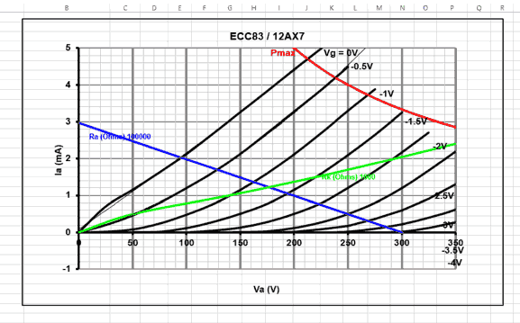

#39 Posted: 6/14/2018 12:57:16 AM
CBG
CBG
78 likes in 312 posts.
Hi Nicolas
Hi Jean
I found this page that I hope will be useful:
http://www.valvewizard.co.uk/links.html
It contains a file in excel for the calculation of the triodes graphs
LoadLinePlotter.xls (817 KiB) downloaded 743 time(s).
Carlos
