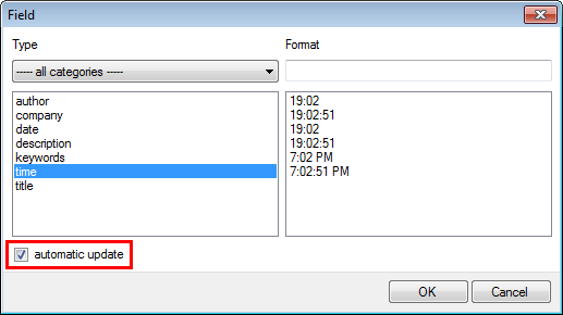

Good Day Davide,
I have used the "Field" functionality for a while now, in particular the "date" and the "worksheet info".
I have noticed that:
1. worksheet info field does not change if the actual smath file properties change
2. date changes the moment smath worksheets is re-opened
Is there a particulat reason for this behaviour? If you consider my suggestion worthwhile I propose to update the worksheet info fields every time the .sm file is opened to scan for changes. Also I propose to update the "date" field only when it is created or copied/cloned elsewhere - it would make sense to track the date when a particular calculation page in a .sm worksheet was created, not the current date/time at the instance of .sm file access.
A.M.

Hello Alex,
Yes, this is because the region is designed to have a low footprint and there isn't an event "File Properties Changed" for the worksheet; but I see that it doesn't changes even on file opening nor for region paste; I'll investigate it ASAP.
I suppose is matter of my habits; if I need a static date/time I write it directly or I convert the field to static text. However I realize that one might want it "less dynamic". What if I add a property for each field to drive the update? (whenever possible or just manual by context menu).

Hello Alex,
Thank you, Davide, both tweaks will be very much welcome, if and when you have time, of course.

PLUGIN UPDATED SMath Studio 0.98.5935 and later
  • Rendering logic refactored to be much more fast (smooth worksheet's scroll on huge regions or even on multiple regions intersecting the viewport);
  • Applied correction on characters' spacing to make them closer to common text editors;
  • Fields: added option to disable automatic updates;
    Show Spoiler
  • Fields: fixed Worksheet's metadata not updated on file open/region paste;

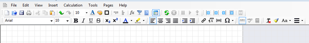

Davide,
Under version 0.98 build 6179 (64 bit) loaded, this plugin does not work as it used to. It used to be that CTR+Shift+W would pop open a "formatting" dialog box (per post #2 "floating toolbar") like the text region utilities. Now it just opens a "text box which is the width of the sheet, but no formatting utilities. Is this because 64 bit loaded up when I upgraded?
PS Same issue with portable version I created with previous version. Can shis toolbar be placed in the side panel with the math/symbols, etc.?
PPS If I left mouse click and go to settings, the floating toolbar pops up. Is there a way to make this the default? (both desktop and portable)

Davide,
Really strange
Only cases in which you should notice changes are on cleaning of settings folder (but this will load the default settings, that aren't the ones listed by you) or by your choice. Please check your settings in the "More..." > "Options..." menu ("New regions" and "Environment" tabs). Settings should be saved once you click on "OK" and never change, except in cases mentioned previously.
Nope. Since next SS relase should be possible to create plug-ins to have more toolboxes, but this won't be the place for Writer Region toolbars.
Show Spoiler

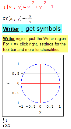

My procedure Win 7, micro laptop:
1. from the insert menu => click the W symbol [insert writer region]
2. the empty rectangle appears [|]
3. click right for the drop down menu => click left "settings"
4. as you start typing in the rectangle the movable tool bar is active.

That is the problem! The movable tool bar is active only after doing all that. It used to pop up @ step #1.
#72 Posted: 3/17/2017 11:21:16 AM
1,443 likes in 2,936 posts.
Have you tried to change your settings?

That is the problem!The movable tool bar is active only after doing all that.It used to pop up @ step #1.
Once you have entered the writer region you have minimal options:
click on a word to Ctrl+B, Ctrl+U [bold, underline].
For the tool bar: click right, click left on 'settings'.
The minimal and advanced options is very ergonomic [to me].
