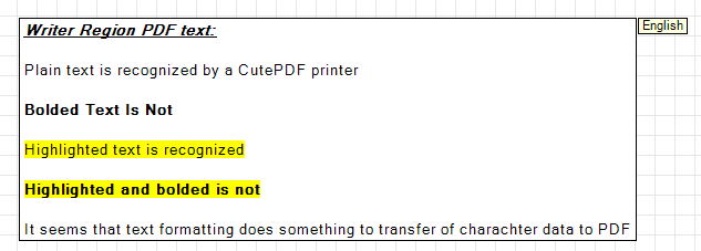

Davide,
Wanted to bring to your attention the following peculiarity of printing .sm file with a writer region to PDF. Not all text is recognized as text in the resulting PDF file (makes the PDF file non-searchable). There is a patter to the madness, so there is hope that something can be done.
Many thanks for the region! I use it all the time.
WriterRegionPrintToPDF.sm (2.18 KiB) downloaded 1698 time(s).
WriterRegionPrintToPDF.pdf (20.83 KiB) downloaded 851 time(s).
#36 Posted: 3/13/2016 3:48:28 PM
1,443 likes in 2,936 posts.
Hello Alex
I'm aware of that; there's not transfer of characters or text between plugins and the pdf printer, the worksheet is processed as an image and the OCR of the printer you use it may produce a better or worst result. Part of the problem however is in the plugin itself because the text is not rendered at "full quality" (because issues in GDI+ vs text measurements); this is something very complex to address, recently I've seen a possible solution/improvement that involves the use of unmanaged code from the OS (namely the technique used by this project:HTML renderer), but I don't know if this may break the plug-in compatibility in some OS (and how much work would be needed to replace the part of code involved).
#37 Posted: 3/13/2016 3:56:02 PM
Alexander O. Melnik
Alexander O. Melnik
127 likes in 498 posts.
Hello Alex
From the sounds of it, the benefit would not justify the difficulty of the tweak.
