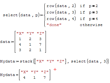

Generalize demo. No sweat to capture [X,Y,Z] from n*m matrix.
Page5 Generalize.sm (5.88 KiB) downloaded 1108 time(s).
