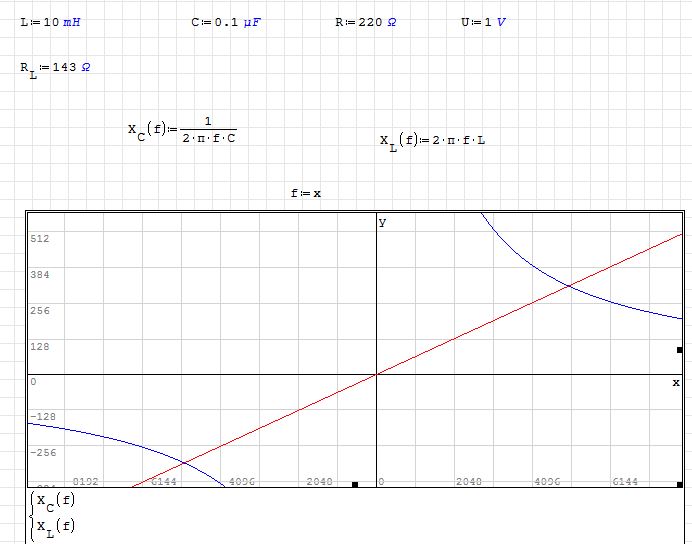

X-Y plot plotting two functions:
Basile

#3 Posted: 2016/6/24 22:42:36
Basile
Basile
8 likes in 172 posts.
Alvaro,
All you say about the physics of the problem, you are right.
But look the mathematics, just plotting a function.
Look above, the X.L(f) plots fine.
Similarly plots fine if I use the Plot-2D.
Basile

#7 Posted: 2016/6/26 07:51:00
1,443 likes in 2,935 posts.
Seems the issue is related to negative infinity
#8 Posted: 2016/6/26 09:18:34
Basile,
What you did is no not correct: You copied the L
plot and put in it the C plot with the same L scales.
So, the C plot flies in the blue. Someting like this:
If you photograph a mouse and an elephant in the same
bed, you won't see both. If you adjust for elephant,
the mouse will be a dot pretty hard to isolate and
enlarge unless you have zillions of MP resolution ...
#9 Posted: 2016/6/26 09:27:34
Forum Basile Plot.sm (4.95 KiB) downloaded 1121 time(s).

#11 Posted: 2016/6/26 16:05:08
The problem is with the X-Y plot. It disappears and freezes the instance of Smath!
As pointed by Davide a possible problem with minus infinity?
NO => Not as you think. X_Y is not an autoplot, it is a plot range.
If you plot sin(x) it falls in its default XY ranges OK. Otherwise
you have to range both directions. X_Y does not supports few things:
1. It does not plot x. It does not understand that 'x' is implicit
of 'x' = "1*x" neither implicit of 'x' = 'x+0'
2. It supports some common Engineering ranges 1*e ±3 [per say]
but will crash Smath instance if you want to range 1*e ± -15
X_Y is lovely in many projects but not in others.

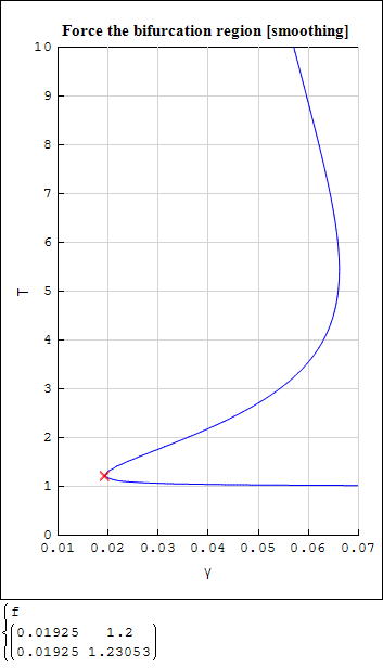

#12 Posted: 2016/6/29 13:02:35
Fridel Selitsky
Fridel Selitsky
520 likes in 451 posts.
By increasing the limit values of the function  the graph does not
pass through a pivotal point
Bug.sm (8.2 KiB) downloaded 1161 time(s).
#13 Posted: 2016/6/29 14:31:53
That's right but not a bug. Just that above the Y magnitude 45,
the canvas misses some points in the critial region.
More: does not fill the circle, plots x instead of +
X_Y Plot wisely.sm (11.2 KiB) downloaded 1178 time(s).
Fridel Selitsky 2016/6/29 14:37:00
#14 Posted: 2016/6/29 14:38:02
