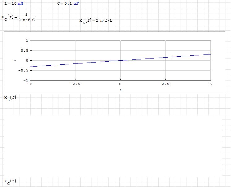

X-Y plot plotting two functions:

Alvaro,
All you say about the physics of the problem, you are right.
But look the mathematics, just plotting a function.
Look above, the X.L(f) plots fine.
Similarly plots fine if I use the Plot-2D.

#7 Опубликовано: 26.06.2016 07:51:00
Seems the issue is related to negative infinity
#8 Опубликовано: 26.06.2016 09:18:34
Basile,
What you did is no not correct: You copied the L
plot and put in it the C plot with the same L scales.
So, the C plot flies in the blue. Someting like this:
If you photograph a mouse and an elephant in the same
bed, you won't see both. If you adjust for elephant,
the mouse will be a dot pretty hard to isolate and
enlarge unless you have zillions of MP resolution ...

#11 Опубликовано: 26.06.2016 16:05:08
The problem is with the X-Y plot. It disappears and freezes the instance of Smath!
As pointed by Davide a possible problem with minus infinity?
NO => Not as you think. X_Y is not an autoplot, it is a plot range.
If you plot sin(x) it falls in its default XY ranges OK. Otherwise
you have to range both directions. X_Y does not supports few things:
1. It does not plot x. It does not understand that 'x' is implicit
of 'x' = "1*x" neither implicit of 'x' = 'x+0'
2. It supports some common Engineering ranges 1*e ±3 [per say]
but will crash Smath instance if you want to range 1*e ± -15
X_Y is lovely in many projects but not in others.
