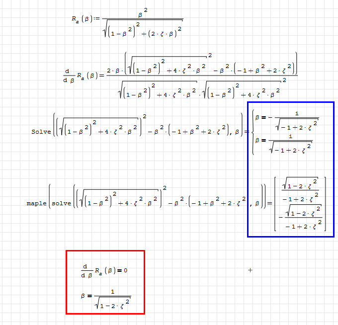

I want to get the real root in symbolic (in red frame) , but solve and maple solve always give me imaginary root (in blue frame).
Edited 2025/9/1 14:15:20

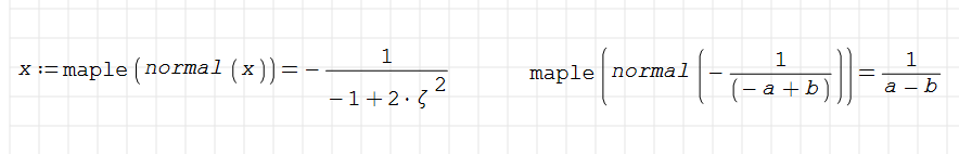

#2 Posted: 2025/9/1 18:09:17
1,532 likes in 1,838 posts.
The answer is correct. The appearance may differ.
The appearance can be normalized, but it doesn't work in this case.
Edited 2025/9/1 18:12:55

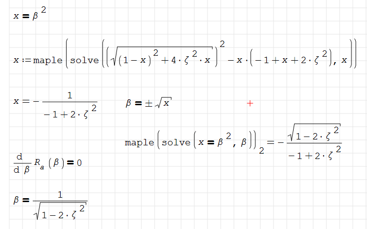

#3 Posted: 2025/9/1 18:52:05
Oscar Campo
Oscar Campo
135 likes in 309 posts.
A simple option is force to find a real solution doing:
then...
best,
Oscar
netsonicyxf 2025/9/2 02:50:54

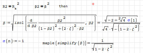

#5 Posted: 2025/9/2 08:40:47
1,078 likes in 1,749 posts.
Hi. Using isol:
isol web.sm (223.27 KiB) downloaded 573 time(s).
netsonicyxf 2025/9/5 13:02:29

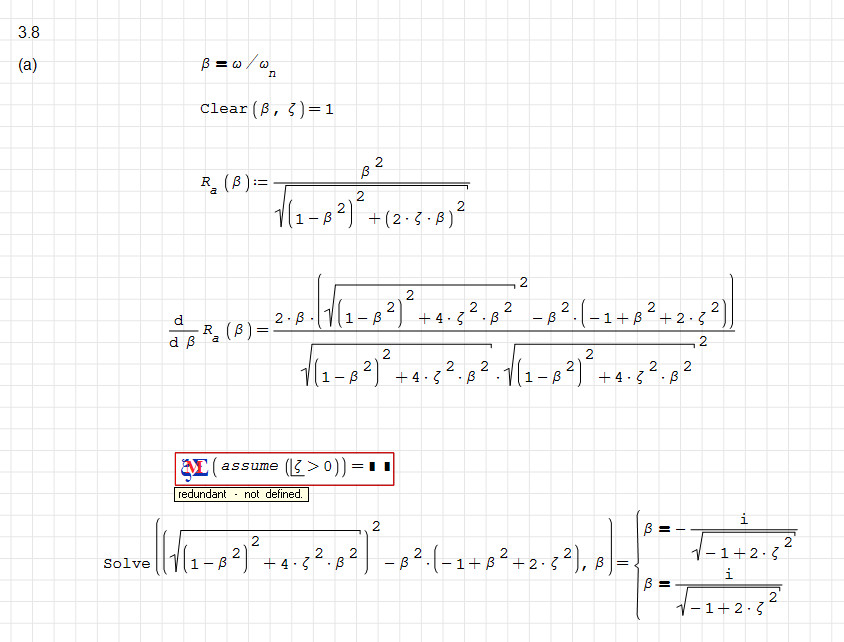

#6 Posted: 2025/10/21 12:38:56
netsonicyxf
netsonicyxf
1 likes in 12 posts.
@Oscar Campo
I can't get answer as you show in the pic. Please see the attached.
real root.sm (11.49 KiB) downloaded 251 time(s).
#7 Posted: 2025/10/30 20:05:33
Valery Ochkov
Valery Ochkov
64 likes in 670 posts.
Sometime I do so:
Edited 2025/10/30 20:05:57
