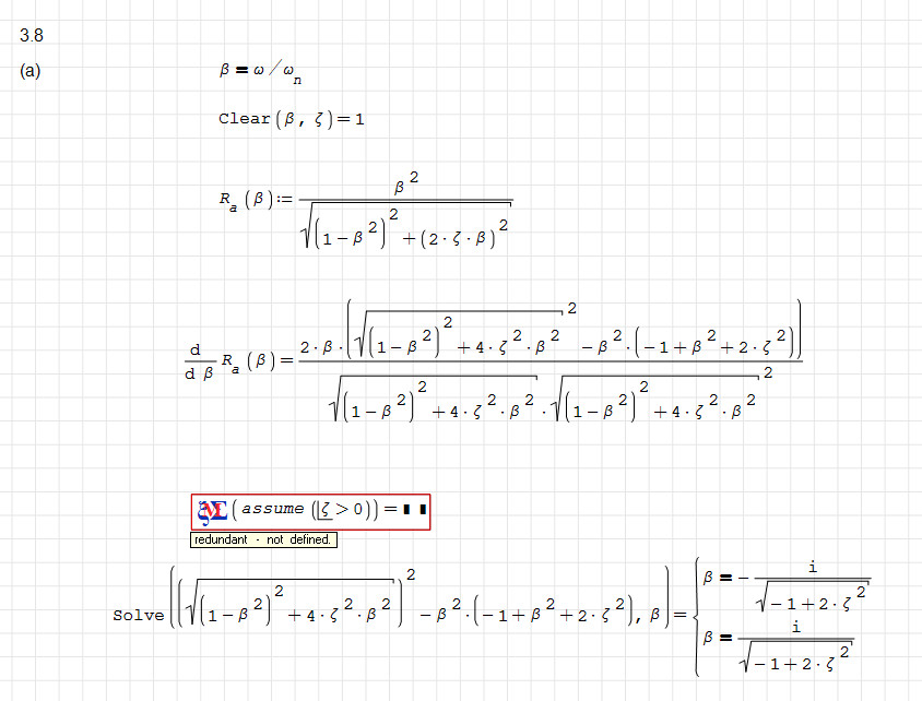

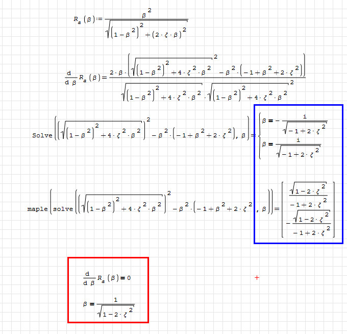

I want to get the real root in symbolic (in red frame) , but solve and maple solve always give me imaginary root (in blue frame).
Отредактировано 01.09.2025 14:15:20

The answer is correct. The appearance may differ.
The appearance can be normalized, but it doesn't work in this case.

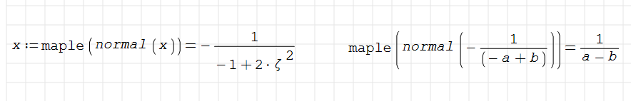

#3 Опубликовано: 01.09.2025 18:52:05
Oscar Campo
Oscar Campo

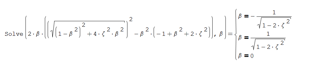

A simple option is force to find a real solution doing:
then...
best,
Oscar

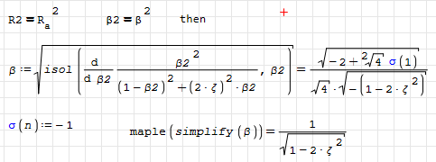

Hi. Using isol:
isol web.sm (223,27 КиБ) скачан 1279 раз(а).

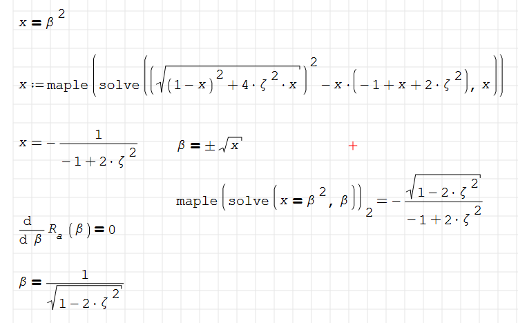

#7 Опубликовано: 30.10.2025 20:05:33
Valery Ochkov
Valery Ochkov
67 сообщений из 708 понравились пользователям.
Sometime I do so:
