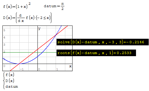

#2 Posted: 2023/4/11 09:06:47
⚜ Kenny Lemens, P.E. ᵂᴵ
85 likes in 180 posts.
Greetings,
To obtain an answer, you are going to have to keep the boolean test out of your diff. equation.

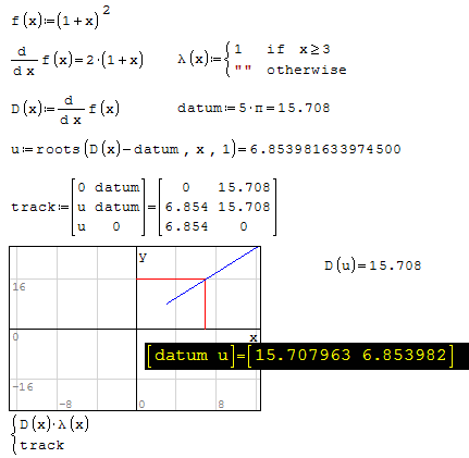

#3 Posted: 2023/4/11 09:44:34
How do you perform such calculation ?
That's my understanding ?
Cheers ... Jean.

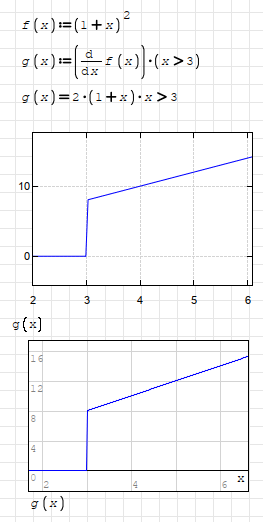

#4 Posted: 2023/4/11 09:53:17
... Smath document.
Pierre.sm (7.86 KiB) downloaded 1182 time(s).

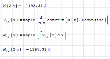

#5 Posted: 2023/4/11 10:01:35
1,123 likes in 1,795 posts.
Hi. If you use maple, maybe this could help.
diff-issue.sm (25.8 KiB) downloaded 1200 time(s).

#7 Posted: 2023/4/11 12:11:44
... It seems that the condition disapears after derivation.
Hi. You're using Heaviside from Statical Tools plugin. I forgot it, because I don't use it, It define Heaviside(x,y) as (1+sign(x-y))/2, which could be cool for numerical procedures, but the derivative of maple of sign(x) is zero, but diff Heaviside(x) /dx is Dirac(x). So, the file that I upload works very different with that plugin. There are also other posts in this forum about Heaviside, Dirac and civil engineering. Maxima have their own implementation of those functions too.

Your latest document is much different than your original.
The golden rule is to specify Bolean completely.
Sometimes it's immaterial ... One exception is DeBoor.
#9 Posted: 2023/4/11 18:41:37
598 likes in 1,380 posts.
Hello everybody,
I have issues regarding diff function and boolean function.
I have been looking on different solution on the forum, but i have not found a related post.
How do you perform such calculation?
diff() function can't parse if original function has boolean expression.
Once derivative is completed result can be booleaned. (is this even a proper word )
Here how it is.
#10 Posted: 2023/4/11 19:47:54
Do you have any idea on how to solve?
Yes. Use maple(diff(convert(M(x),Heaviside),x)) for convert SMath sign function into Maple Heaviside's. It looks ok now:
e7_5_3-hs ok.sm (139.5 KiB) downloaded 1231 time(s).
