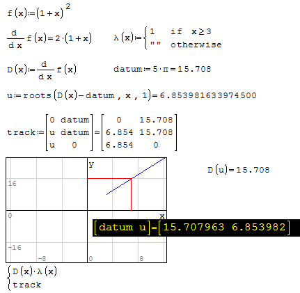

#8 Опубликовано: 11.04.2023 13:12:19
Your latest document is much different than your original.
The golden rule is to specify Bolean completely.
Sometimes it's immaterial ... One exception is DeBoor.

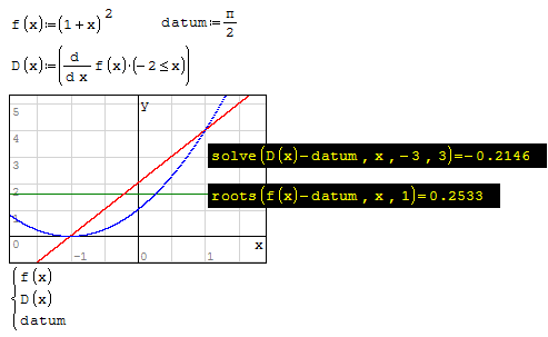

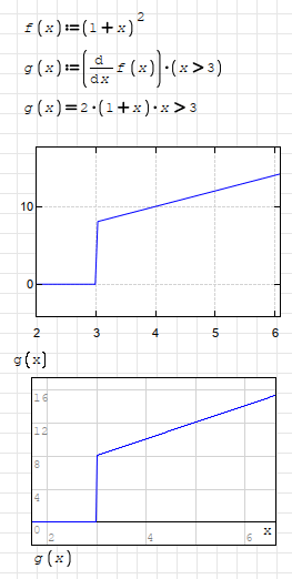

#9 Опубликовано: 11.04.2023 18:41:37
599 сообщений из 1 380 понравились пользователям.
Hello everybody,
I have issues regarding diff function and boolean function.
I have been looking on different solution on the forum, but i have not found a related post.
How do you perform such calculation?
diff() function can't parse if original function has boolean expression.
Once derivative is completed result can be booleaned. (is this even a proper word )
Here how it is.

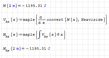

#10 Опубликовано: 11.04.2023 19:47:54
Do you have any idea on how to solve?
Yes. Use maple(diff(convert(M(x),Heaviside),x)) for convert SMath sign function into Maple Heaviside's. It looks ok now:
e7_5_3-hs ok.sm (139,5 КиБ) скачан 1367 раз(а).
