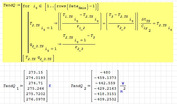

I've tried CTRL+A and changing the optimization from symbolic to numeric on this sheet already, it did not help with my calculation run time. I'm hoping somebody can lead me in the right direction!
I've highlighted the loop that I'm trying to calculate.
I also tried running the sheet without any units and it took under a second to calculate. Is it normal for SMath to perform this way?
In-Class 2.6_1D conduction_SS and TS.sm (65.67 KiB) downloaded 625 time(s).

Hi. Check Delta_t.TS please.
