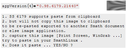

Can you in your latest SS copy few math regions and paste in IrfanView.
SS 6179 can't ... Mathcad 8, 11 can for unlimited number of regions ... pages.

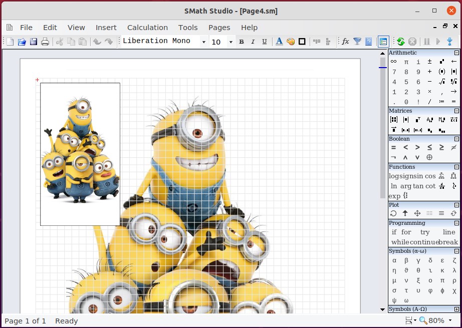

Here let me demonstrate it with a video for you to explain it more detailed.
Linux Picture Insert Bug Video
Somehow SMath is not getting full picture data, this is not Linux bug. This is a SMath bug on Linux.

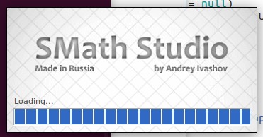

New test version prepared: http://smath.com/file/UMobd
  • Loading splash screen layout fixed:
  • Work with images fixed (save/open files with images, image regions copy/paste, background images)
  • Dark OS theme supported now (not all toolbox icons are vectorized yet - this is test version);
sergio 2020/10/23 06:52:00, Вячеслав Мезенцев 2020/10/23 09:48:00, overlord 2020/10/23 11:34:00

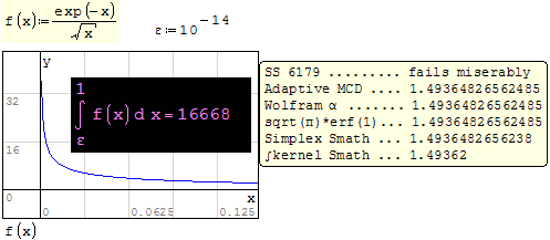

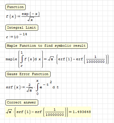

By the way, the calculation you have sent is a Gauss Error Function. erf()
Apparently SMath don't have it yet but you can implement it easily.
Maybe Andrey will add erf() someday, who knows.
I have calculated this on windows. Maple don't work on linux, yet.
#18 Posted: 2020/10/23 21:19:04
Thanks for checking latest SS
Erf(x) is built-in since at least SS 5346 erf(1) from f(x) menu
erf(x) is a monkey business approximation [Mathematica]
But works well in Smath, presumably all versions.
Maths erf(x).sm (32.6 KiB) downloaded 1292 time(s).

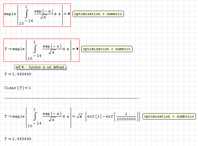

erf() is not built-in to SMath, I have checked.
It is a function of Statistical Tools plugin.
That plugin was not installed on my setup.
I have installed the Statistical Tools plugin to get erf().
It works but still gives "erf() function is not defined" error with maple.
Numeric optimization is causing this when I try to get a numeric result.
However it is calculating the expression and giving the result assigned to a variable, even with numeric optimization.
No issues with symbolic optimization I guess.
Odd behavior.
