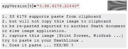

#10 Posted: 10/22/2020 8:31:30 PM
Let it go step by step, this first step
Can you in your latest SS copy few math regions and paste in IrfanView.
SS 6179 can't ... Mathcad 8, 11 can for unlimited number of regions ... pages.
If you haven't experimented Venturi as described, sorry but end of it.

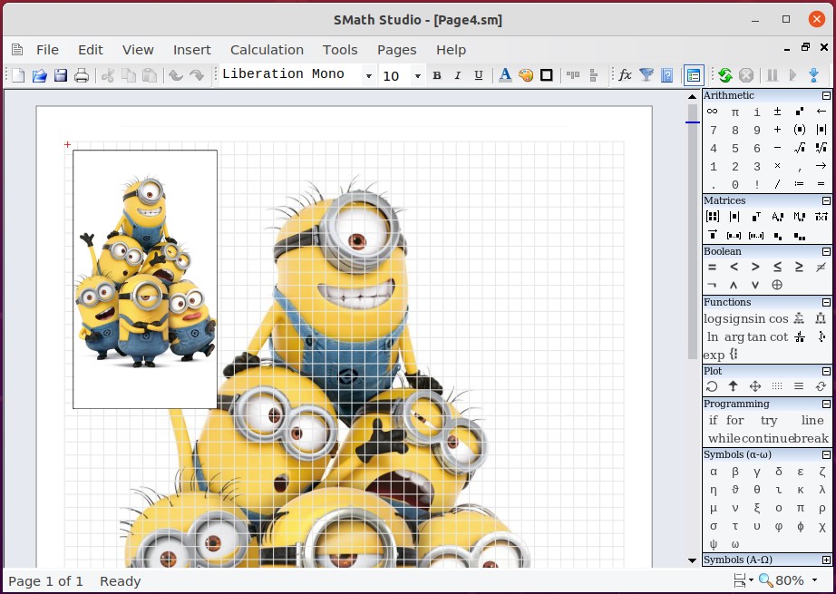

#13 Posted: 10/23/2020 6:49:17 AM
2,343 likes in 4,055 posts.
New test version prepared: http://smath.com/file/UMobd
  • Loading splash screen layout fixed:
  • Work with images fixed (save/open files with images, image regions copy/paste, background images)
  • Dark OS theme supported now (not all toolbox icons are vectorized yet - this is test version);
sergio 10/23/2020 6:52:00 AM, Вячеслав Мезенцев 10/23/2020 9:48:00 AM, overlord 10/23/2020 11:34:00 AM

#15 Posted: 10/23/2020 11:34:58 AM
599 likes in 1,381 posts.
All is good here, dragging picture from file managers works too.
Thank you Andrey for quick response.

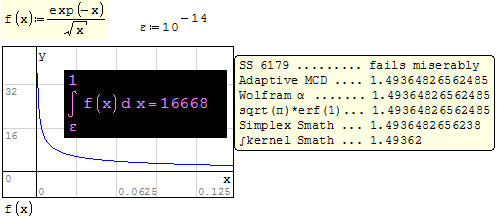

Just update your SMath to latest version for full features
Not long ago, SS 7959 integration had to be doctored.
Please try that one for the benefit of the Community.

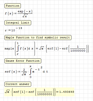

By the way, the calculation you have sent is a Gauss Error Function. erf()
Apparently SMath don't have it yet but you can implement it easily.
Maybe Andrey will add erf() someday, who knows.
I have calculated this on windows. Maple don't work on linux, yet.
Thanks for checking latest SS
Erf(x) is built-in since at least SS 5346 erf(1) from f(x) menu
erf(x) is a monkey business approximation [Mathematica]
But works well in Smath, presumably all versions.
Maths erf(x).sm (32.6 KiB) downloaded 1439 time(s).

erf() is not built-in to SMath, I have checked.
It is a function of Statistical Tools plugin.
That plugin was not installed on my setup.
I have installed the Statistical Tools plugin to get erf().
It works but still gives "erf() function is not defined" error with maple.
Numeric optimization is causing this when I try to get a numeric result.
However it is calculating the expression and giving the result assigned to a variable, even with numeric optimization.
No issues with symbolic optimization I guess.
Odd behavior.
