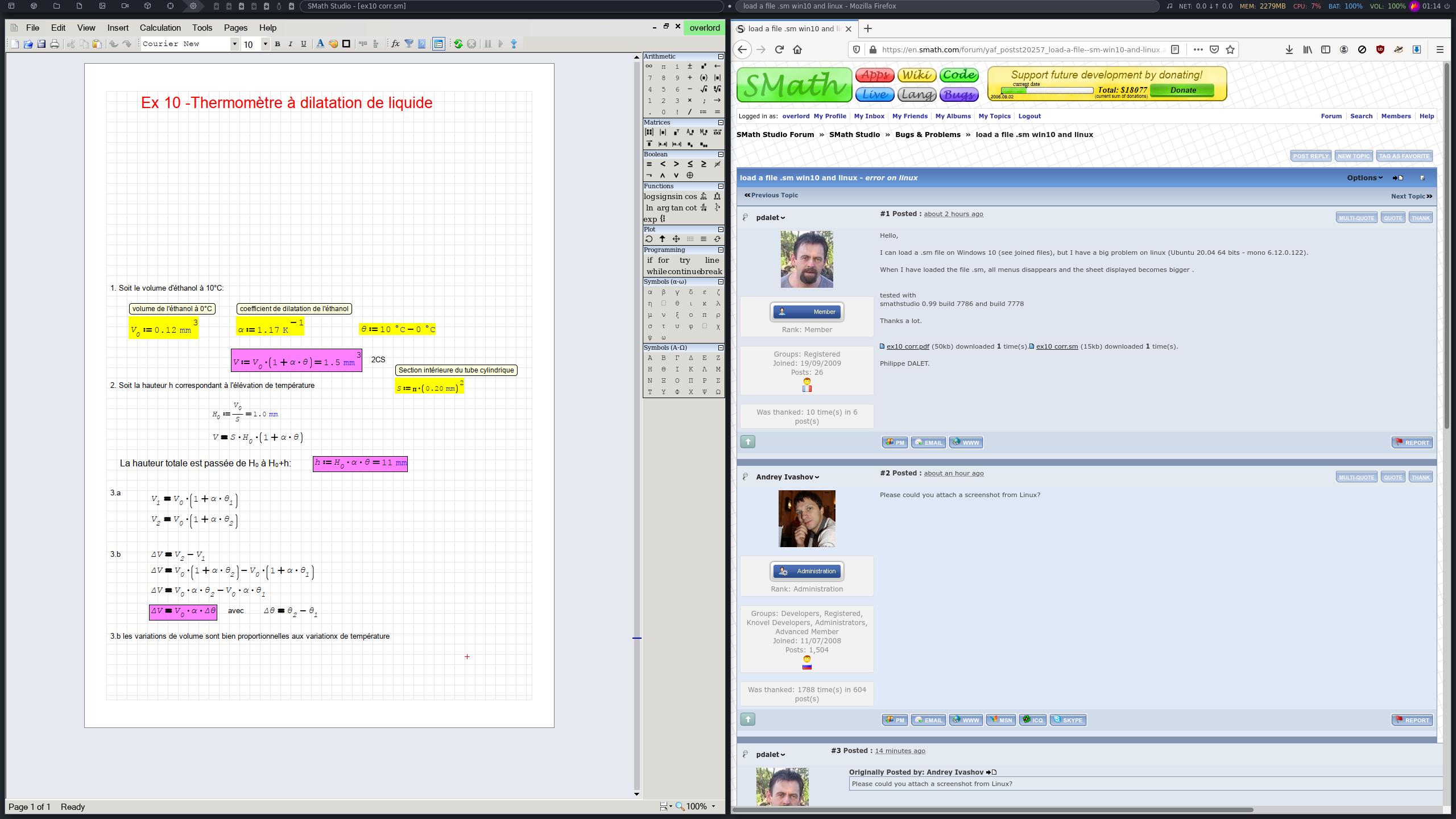

I can load a .sm file on Windows 10 (see joined files), but I have a big problem on linux (Ubuntu 20.04 64 bits - mono 6.12.0.122).
When I have loaded the file .sm, all menus disappears and the sheet displayed becomes bigger .
tested with
smathstudio 0.99 build 7786 and build 7778
Thanks a lot.

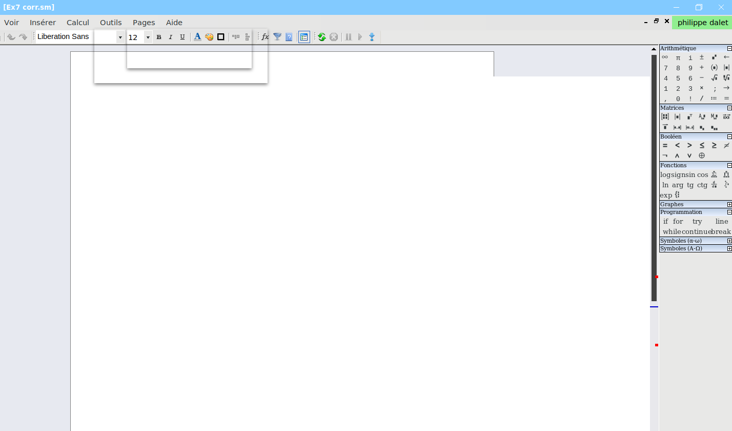

Hello Andrey ,
I run smathstudio on a terminal and no error messages are displayed in the terminal.

Hello Andrey,
I have found the origin of the bug.
In text region (only on linux)
changing
with eliminates the bug.
no bug on Win10
ph.D
Andrey Ivashov 2021/5/9 07:11:00
Hello.
Please could you try to replace "Arial" with some another Font name installed on your system? Unfortunately I cannot reproduce a bug, but maybe it is because Arial is not available on your system?
If other fonts will work I think I could try to fix this problem.
WroteIn text region (only on linux)
changingwith eliminates the bug.
WroteHello.
I have install Arial fonts on ~/.fonts folder, and the display is correct.
All is OK
Thanks.
