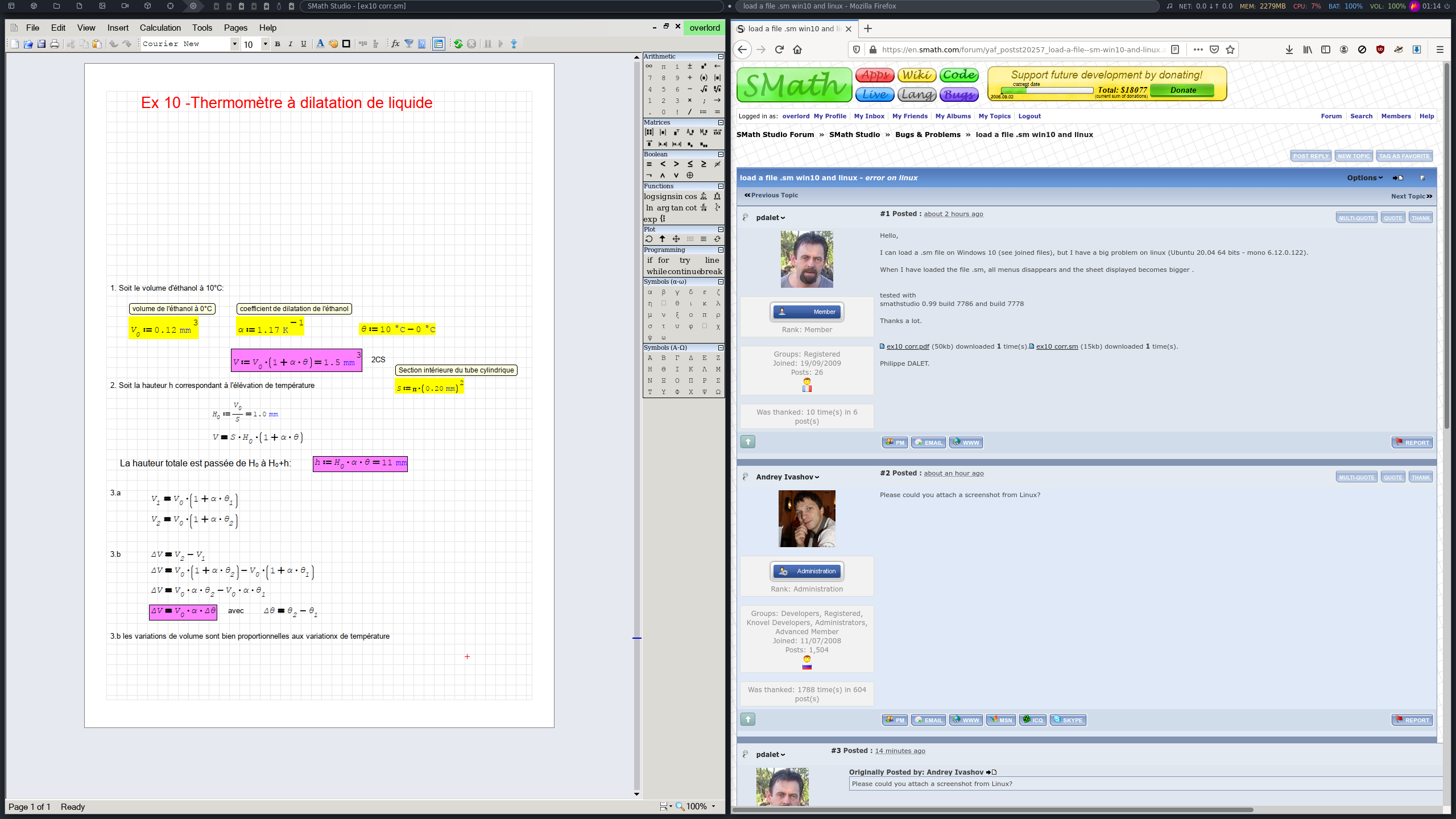

I can load a .sm file on Windows 10 (see joined files), but I have a big problem on linux (Ubuntu 20.04 64 bits - mono 6.12.0.122).
When I have loaded the file .sm, all menus disappears and the sheet displayed becomes bigger .
tested with
smathstudio 0.99 build 7786 and build 7778
Thanks a lot.
Philippe DALET.

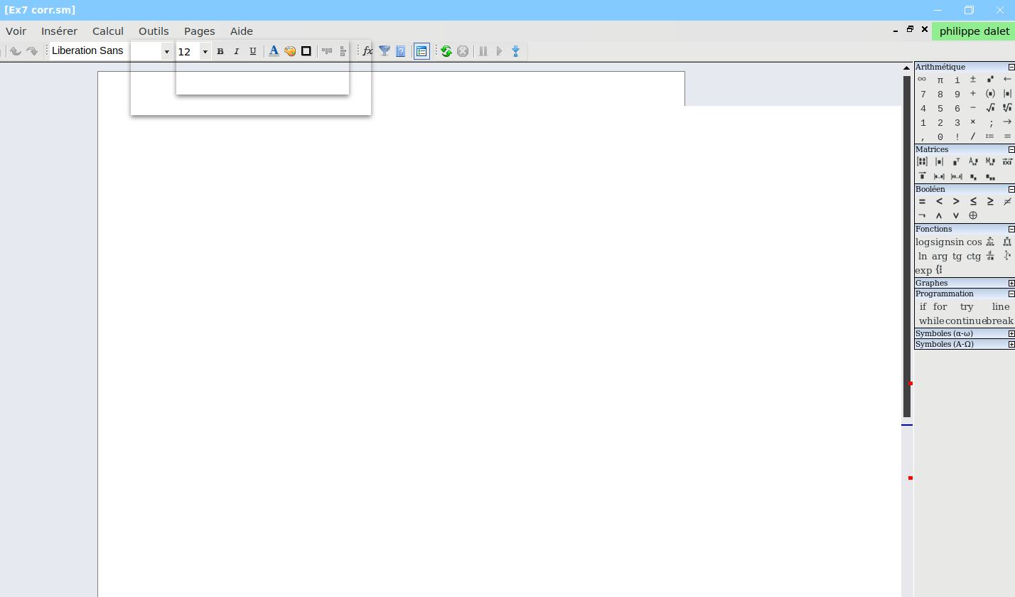

Please could you attach a screenshot from Linux?
#3 Опубликовано: 26.04.2021 18:59:21
philippe dalet
philippe dalet
18 сообщений из 34 понравились пользователям.
philippe
Andrey Ivashov 26.04.2021 19:42:00
#4 Опубликовано: 26.04.2021 19:15:06
Nothing is wrong with my setup.
#5 Опубликовано: 26.04.2021 19:42:52
Группа: Super Administrator
Thank you. Will check this issue.

Hello Andrey ,
I run smathstudio on a terminal and no error messages are displayed in the terminal.

I have done the same operation with SMathStudioDesktop.0_99_7691.Mono.
All is OK. No errors.

I have found the origin of the bug.
In text region (only on linux)
changing
with
eliminates the bug.
no bug on Win10
ph.D

Hello.
changing
with
eliminates the bug.
Please could you try to replace "Arial" with some another Font name installed on your system? Unfortunately I cannot reproduce a bug, but maybe it is because Arial is not available on your system?
If other fonts will work I think I could try to fix this problem.

I have install Arial fonts on ~/.fonts folder, and the display is correct.
All is OK
Thanks.
