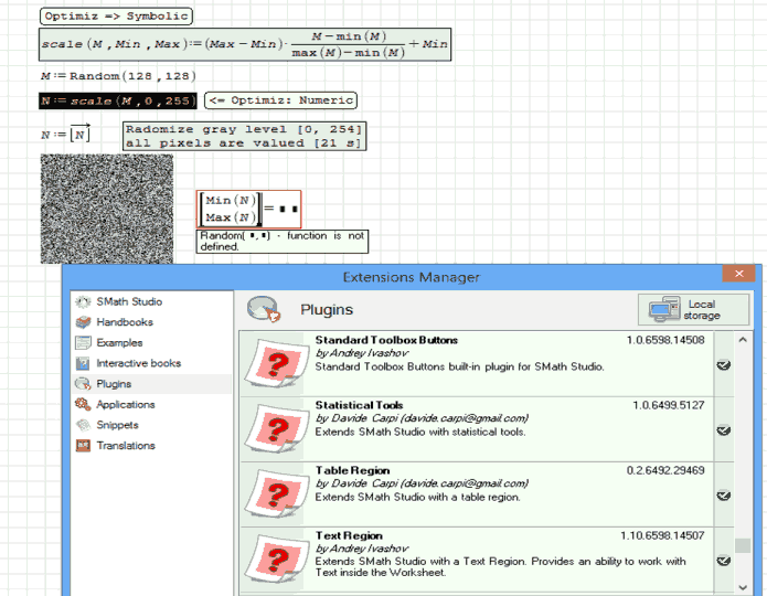

Do you have the statistical tools plugin installed?
That is required for the Random(2) function.
Davide, previously had already checked with the portable
distribution of Martin Kraska and the file runs without
any problem, recognizing the statistical functions.
As the portable distribution is 32 bits, I thought that
the problem was that Smath Studio to 64 bits, did not
recognize the statistical tools plugin
the problem as that Smath Studio to 64 bits, did not
From your screenshot seems that the plgin is recognized (green in loaded plugins) but the functions are not loaded for some reasons. I have recompiled the plugin for the latest SS beta, please try if this works for you (plugin recompiled as beta too).
The plugin has a very strange behavior.
I deleted the current plugin and loaded the updated, ran the file and executed perfectly.
I closed smath studio and reopened it, ran the file again, and the statistical functions were not recognized again.
Carlos
WroteHello Davide
Carlos
Delete does not do what you expect. You must evaporate
"evaporate" is my word to make understand what it has to do.
What you have to do may depend upon Win Registry.
Smath has only two Registry entries that can be rocognized
maybe there are more. My understanding is that Delete does not
act in the Win Registry, that's why on re-opening, it takes
back the previous Registry.
When installing Mathcad 11, we had to "evaporate" any/all
Mathcad/Mathsoft in all Registry Keys.
Evaporate did doctor 100's +++ new MCD 11 users.
On the other hand the matrix size is too huge for 6179.
Alternately, it turns the work sheet blank, open new sheet, go back.
Instead of turning blank, it may just reply Random(,,) Not defined.
On the other hand, the new Smath 64 bits may not be be compatible to
the maybe 32 bits Statistical plugin. If so, real disaster ...
it would turn red ~ 3 dozens documents from my collection [suicide case].
