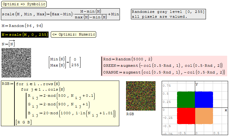

Added: a refreshed version.
Random_5 Matrix [RGB].sm (102.19 KiB) downloaded 796 time(s).
