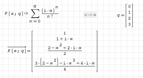

See attached;
Eulers Eqation 2 7-4-23.sm (11.61 KiB) downloaded 1162 time(s).

apha undefined + symbolic optimization

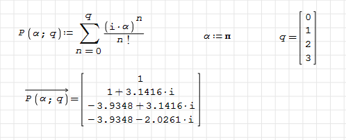

apha define + numerical optimization
