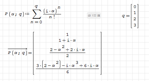

Replacing repetitive equations with a range loop.
Replacing repetitive equations with a range loop. - I want to replace a series of equation with one loop within a defined range. - Messages

See attached;
Eulers Eqation 2 7-4-23.sm (11.61 KiB) downloaded 1347 time(s).

apha undefined + symbolic optimization

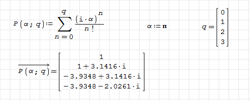

apha define + numerical optimization
