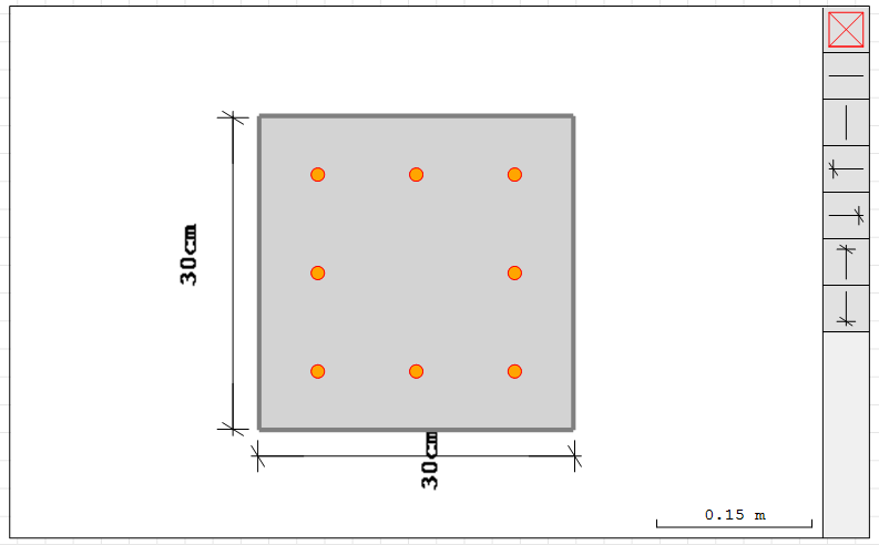

Hi, I want to set my label to vertical dimension but when I rotate the text it gets distorted, please how can I fix it?

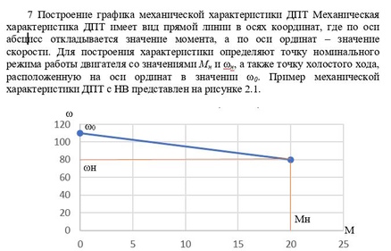

#2 Posted: 2023/2/26 13:23:18
TopUser2000
TopUser2000
0 likes in 28 posts.
Hello.
Tell me, please, if I have two points, then how can I plot a graph between them? According to my assignment, I need to build several graphs, but I do not know how to do it in the program. I have done the calculations, but for the rest I ask for help from local experts. I attach a sheet with the task and a file with calculations (sorry, that's in Russian). Can someone help me figure it out here?
DPT s NV.sm (19.52 KiB) downloaded 1212 time(s).
Mekhanicheskie kharakteristiki DPT s nezavisimym vozbuzhdeniem.docx (95.56 KiB) downloaded 618 time(s).

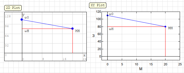

#3 Posted: 2023/2/26 14:31:43
598 likes in 1,380 posts.
I made a sample with two different plots.
You can use them by changing variables.
DPT_NV plot.sm (11.08 KiB) downloaded 1177 time(s).

#5 Posted: 2023/2/26 21:09:46
TopUser2000 2023/2/27 05:03:00
#6 Posted: 2023/2/26 21:21:08
You can also use line and polyline commands for plot.
They work only in XYPlot, but sometimes they make everything easy.
There is also a setprop() function.
It can change format of your XYPlot automatically.
Search setprop() in forum for further information.
DPT_NV plot.sm (20.47 KiB) downloaded 1332 time(s).

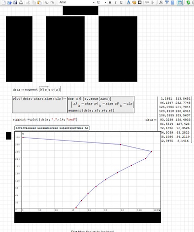

#7 Posted: 2023/2/27 04:54:30
TopUser2000
TopUser2000
Thanks to everyone. The first answer helped me enough)
One more question:
if I have a graph (attached file), then how do I mark the points along which it passes?
I tried: vector M(s) ω(s) "." 15 "blue"
but the application immediately crashes.
AD.sm (20.17 KiB) downloaded 1138 time(s).
Is it possible to make the graph automatically scale to the new values?
And does someone use android version of Smath (from this site)? I can't edit any of these files there.
#8 Posted: 2023/2/27 08:47:08
If I have a graph (attached file), then how do I mark the points along which it passes?
As in the attached.
Instead of re-scaling the same graph, plots all new graph on the same plot.
You will scale to accommodate for the larger graph.
AD Plot Points.sm (104.39 KiB) downloaded 1224 time(s).

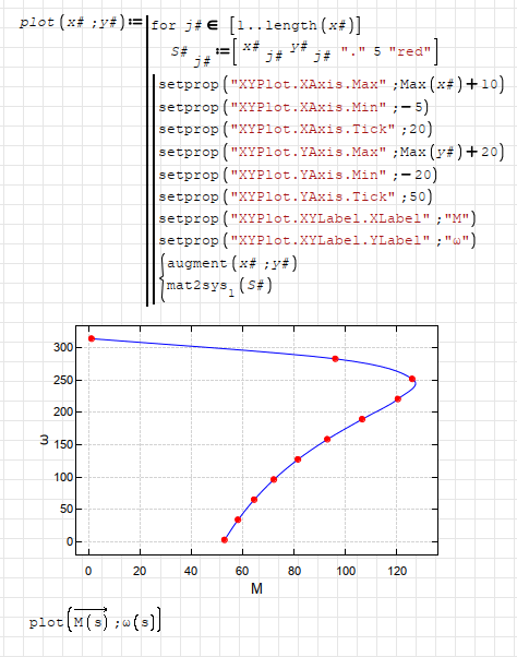

#11 Posted: 2023/2/27 13:57:37
You can use this, XYPlot region is suitable.
One custom function to plot everything.
It also autoscale the graph.
AD.sm (28.23 KiB) downloaded 1122 time(s).
