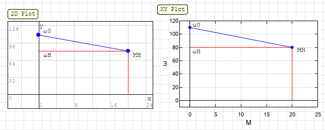

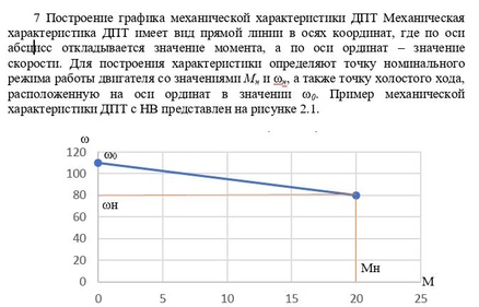

Hello.
Tell me, please, if I have two points, then how can I plot a graph between them? According to my assignment, I need to build several graphs, but I do not know how to do it in the program. I have done the calculations, but for the rest I ask for help from local experts. I attach a sheet with the task and a file with calculations (sorry, that's in Russian). Can someone help me figure it out here?

I made a sample with two different plots.
You can use them by changing variables.

TopUser2000 2/26/2023 3:06:00 PM
#4 Posted: 2/26/2023 5:33:26 PM
TwoPointsPlot.sm (11.84 KiB) downloaded 1335 time(s).

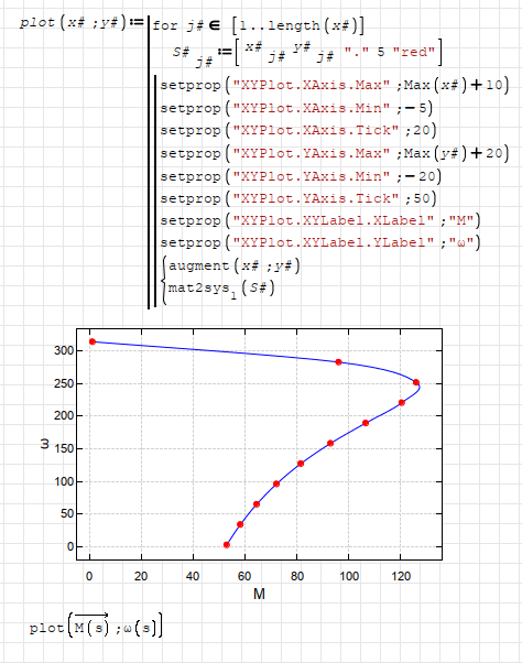

Thanks to everyone. The first answer helped me enough)
One more question:
if I have a graph (attached file), then how do I mark the points along which it passes?
I tried: vector M(s) ω(s) "." 15 "blue"
but the application immediately crashes.
AD.sm (20.17 KiB) downloaded 1309 time(s).
Is it possible to make the graph automatically scale to the new values?
And does someone use android version of Smath (from this site)? I can't edit any of these files there.

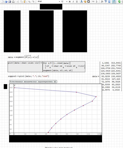

#8 Posted: 2/27/2023 8:47:08 AM
WroteIf I have a graph (attached file), then how do I mark the points along which it passes?
As in the attached.
Instead of re-scaling the same graph, plots all new graph on the same plot.
You will scale to accommodate for the larger graph.
AD Plot Points.sm (104.39 KiB) downloaded 1388 time(s).

WroteIs there any simple way to add the pass points and autoscale a graph?
Some Smath versions decided that opening in other versions will be black.
1. Open this document
2. If black, select by groups, click on background white
3. Make the all document as per 2. directive
4. at this point, you have recovered my original
5. Plot points and more advanced.
AD Plot Points TopUser2000.sm (87.24 KiB) downloaded 1323 time(s).

You can use this, XYPlot region is suitable.
One custom function to plot everything.
It also autoscale the graph.
AD.sm (28.23 KiB) downloaded 1286 time(s).
