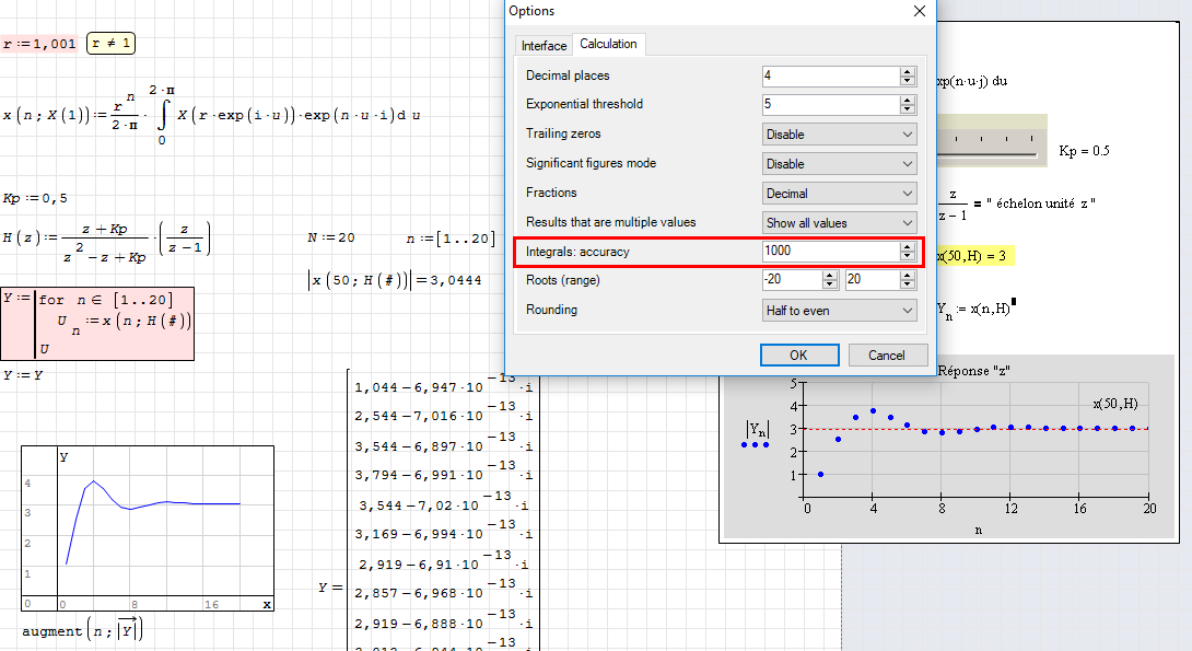

2018-12-11 00_34_33-SMath Studio - [Inst_PID Discrete Schema EXAMPLE_6 - fixed.sm].png
  • removed answer requested for first argument of the last system;
  • used f(number_of_arguments) function of function argument (more elegant, point out that the variable name doesn't matter);
P.S. To obtain similar results, change the integration accuracy to something higher than 100
2018-12-11 00_53_52-SMath Studio - [Inst_PID Discrete Schema EXAMPLE_6 - fixed.sm_].png

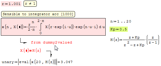

Dumb question maybe, but how do you get the '#' to show up in the H(#) function call?
#6 Posted: 2018/12/11 00:50:47
As simple as that: x(n,X(▄)) ... simply the native dummy argument
big square imitation Alt220 ... try it.
Thanks all you Doctors ! Just refreshing that huge collection
of PID examples, coming soon.

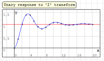

#9 Posted: 2018/12/13 19:02:18
1,123 likes in 1,795 posts.
Hi. This is the setup for use inverse laplace transform for numerically evaluate the response for a system in z domain.
pid_controler z.sm (50 KiB) downloaded 1099 time(s).
