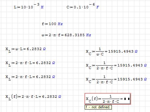

I am getting the following:
Basile
#2 Posted: 2016/6/24 21:39:49
1,123 likes in 1,795 posts.
Hi Basile.
That's is the expected way to work with smath.
To get the value of X.C you must to call the function after defining X.C with X.C(f)=

Alvaro,
Look to the left the of X.C , the X.L
Should behave the same?

Alvaro,
Basile
Depending which version, it could be. I guess that must to be an election from author, this is, if eval functions in that way. The "not evaluation" option, as the attached picture, it's ok for me.

Hi Basile. I don't confusing. Reactances ( https://en.wikipedia.org/wiki/Electrical_reactance ) are reals and impedances ( https://en.wikipedia.org/wiki/Electrical_impedance ) are complexes. So X.L, X.C can't have j.
About the numerical evaluation for a function, check this old post: http://en.smath.info/forum/yaf_postst640_Function-as-a-program.aspx
In X.L, X.C definitions as functions, f must to be a local variable. X.L(f) -> (symb evaluation) must to set the answer with "f", not with "100 Hz". And the numerical evaluation X.L(f) = must to be in red, as f as local variable isn't defined.
As a choice of the program writer, and what you can see in the last post of the above referenced, you can set all the local variables as globals with f(x) = 1*(line ... ). Actually I'm not comfortable with that behavoir, but is the choice of Andrei.

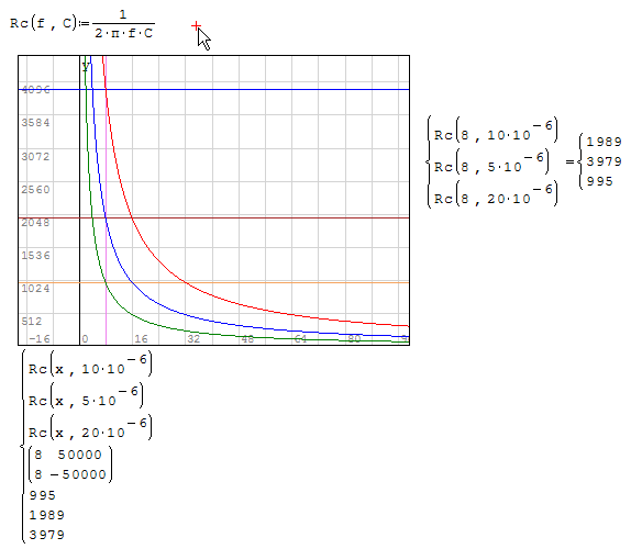

Just like this Basile, for a family of "C's"
at a fixed frequency 8 the magenta line.
On the plot, 'f' => 'x'.

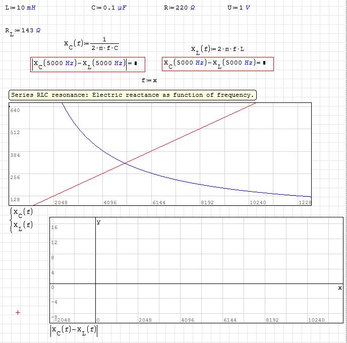

#14 Posted: 2016/6/26 14:59:10
Basile
Basile
8 likes in 172 posts.
Jean,
Yes, I can plot X.C(f) and X.L(f) but if I try to plot the difference or take the aritmetic difference does not work.
Please see figure and figure in post #1 on top, if it helps.
Basile

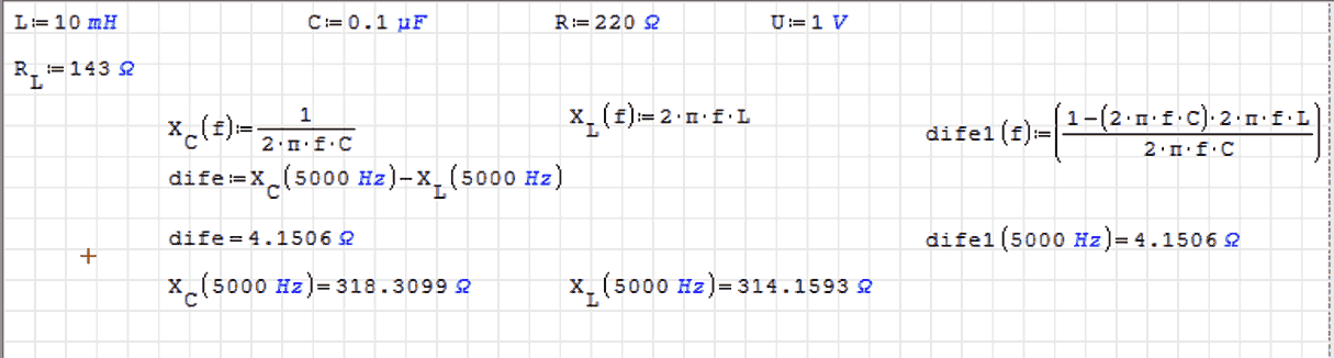

test resonance_CBG.sm (10.1 KiB) downloaded 1025 time(s).
