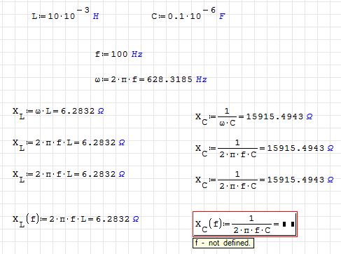

I am getting the following:
Basile

Hi Basile.
That's is the expected way to work with smath.
To get the value of X.C you must to call the function after defining X.C with X.C(f)=

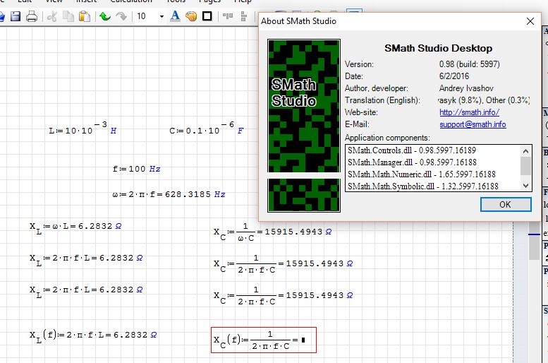

#4 Опубликовано: 24.06.2016 23:02:38
Alvaro,
Look to the left the of X.C , the X.L
Should behave the same?
Basile
Depending which version, it could be. I guess that must to be an election from author, this is, if eval functions in that way. The "not evaluation" option, as the attached picture, it's ok for me.

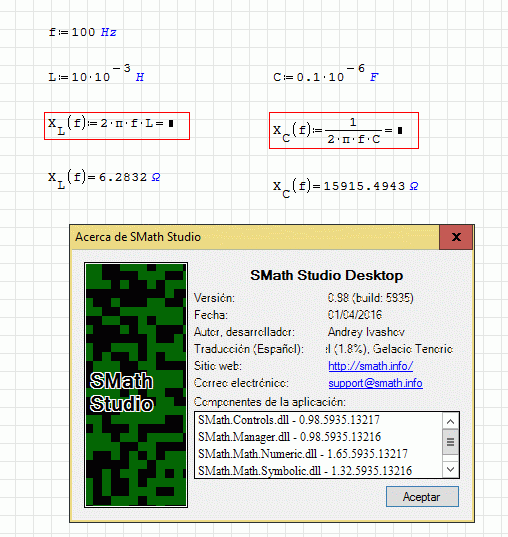

i am using
Basile

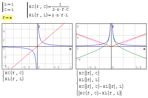

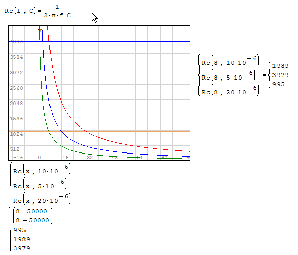

#13 Опубликовано: 26.06.2016 02:01:29
Just like this Basile, for a family of "C's"
at a fixed frequency 8 the magenta line.
On the plot, 'f' => 'x'.

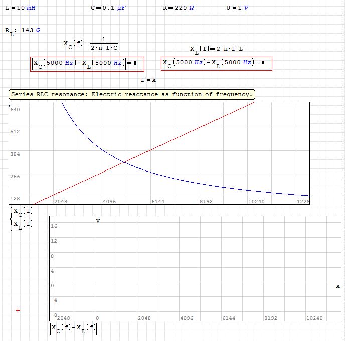

#14 Опубликовано: 26.06.2016 14:59:10
Basile
Basile
8 сообщений из 172 понравились пользователям.
Jean,
Yes, I can plot X.C(f) and X.L(f) but if I try to plot the difference or take the aritmetic difference does not work.
Please see figure and figure in post #1 on top, if it helps.
Basile

#20 Опубликовано: 27.06.2016 13:54:29
CBG
CBG
Redefining subtraction or function.
Carlos
test resonance_CBG.sm (10,1 КиБ) скачан 1200 раз(а).
