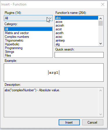

go to insert > functions... and play with the plugins dropdown to see what functions are carried by each plugin, also by Special Functions

Kinda like this.....
