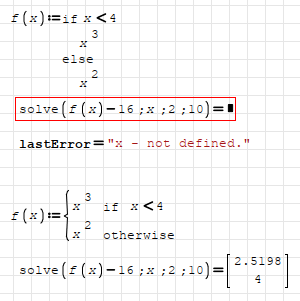

Update of statement:
solve(), roots(), FindRoot() doesn't like if() function.
However, they can solve when cases() used instead of if().

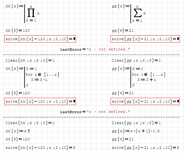

I have diagnosed the symptoms with solve bug.
Made a page about this and tried to explain with detail.

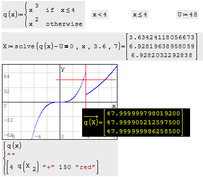

Often, the solve bloc is ~ exact, sometimes exact
At worst 4/5 decimals.
Always start true Bolean #≤# ...
often won't complain incomplete #<#
From recollection, only DeBoor needs incomplete.

#5 Posted: 2021/6/12 15:24:02
IMHO, its logical solving piece wise discontinuous,
solve piece wise as well for productive classroom.

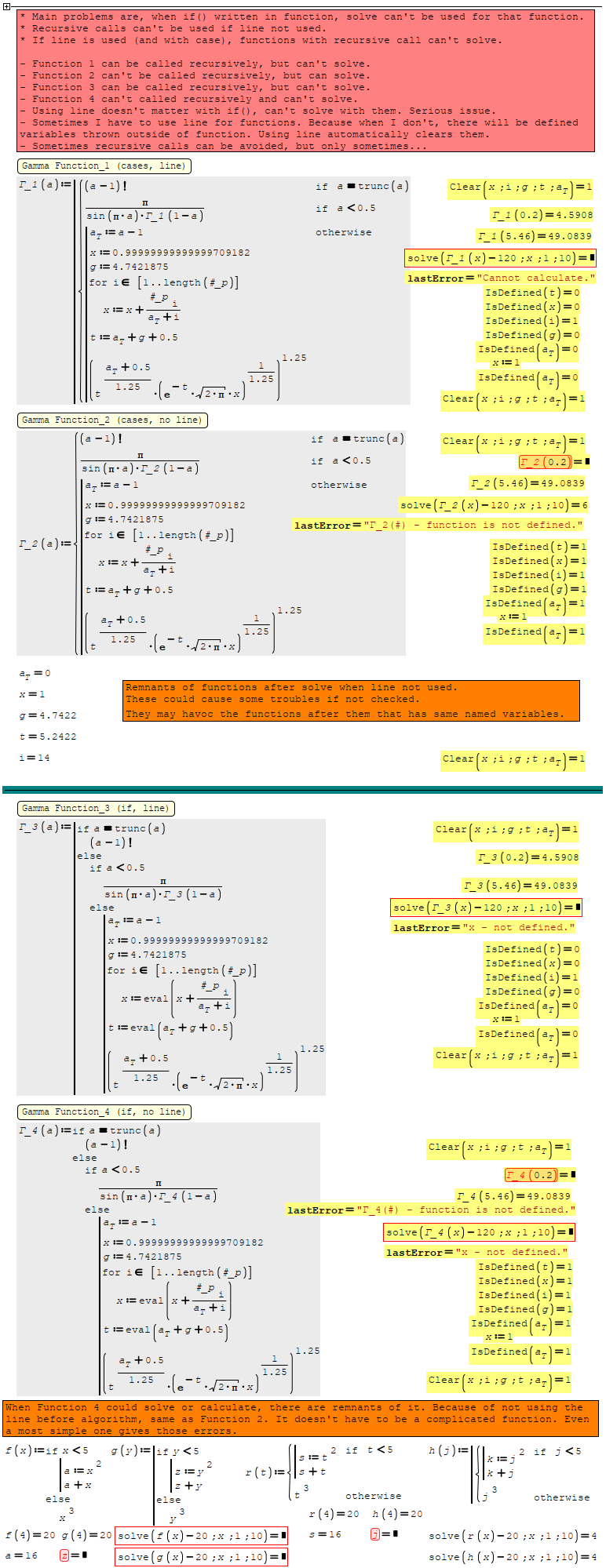

There are other bugs too.
otherbugs.sm (13.7 KiB) downloaded 812 time(s).
