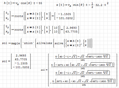

Hi Sergio. There are a 3 argument version of roots, where the third is a guess value for the root.

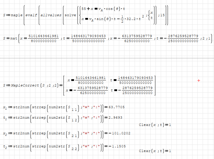

Here your solution solved with maple plugin.
No need to enter guess points for this.
Maxima can solve it too, similarly.
PS: MapleCorrect() function can be found here.
Assign() function can be used instead of str2num() + num2str() + strrep().

Hi. This is another way.
