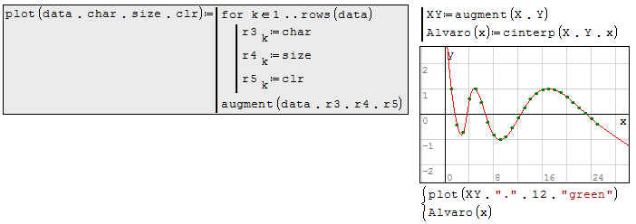

#5 Posted: 2018/8/29 00:35:12
Hi Jean. Thanks, but you know me ... I want to use my own function.
I messed your coding to make readable.
As it looks, you seem to implement Hermite cubic or an unknown brew ?
Hermite [the Draftsman spline] fits better in certain region,
but is discontinuous at junctions and as such has little interest.
In short, it can be used to create some additional best points
for the next more conventional l_p_c splines, for them now to
be continuous at points, thus analytical up to 2nd order derivative.
Hermite was exhausted in Mathcad, all converted Smath.
If of interest, will be please to attach.
Your original coding did calculate 'V' , but not the freaked code.
Some sort of "shadow in context".
cspline test[NFG].sm (53.23 KiB) downloaded 1003 time(s).

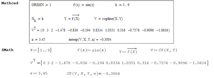

#6 Posted: 2018/8/29 02:49:38
1,123 likes in 1,795 posts.
Hi Jean. There are not to much shadow in that small code. It's just the implementation of the traditional spline interpolation. In SMath there are not, or I can't found, the function cspline. The interpolation with cinterp in SMath evaluates the vector V each time that you call it, it's always better to have V=cspline(X,Y) and then call interp(V,X,Y,x). Finally, I want to implement an adaptive step size for the intervals in X. But first I see very convenient to have vectorization and plotting issues solved.
CS only do what mathcad's cspline do:
#7 Posted: 2018/8/29 16:16:49
CS only does what Mathcad's cspline does:
1. You have a good point, but invalid: cinterp(X,Y,x) works faster than Mathcad [I tested long time ago].
2. Not supporting vectorization has only one answer to me:
all that stuff is scalar wrt 'x' for the canvas plot only,
but it is NOT a real scalar function like the built-in ones ... sin(x), cos(x), exp(x) ...
3. For the adaptive step size, you may have to invent the wheel or implement
Robert A. [Lagrange quadratic knots ... stricking example attached].
Resume:
1. cinterp => hyperfast
2. Vectorization ... left unsolved
3. adaptive step size => suggested
Thanks Alvaro, most interesting ... Jean

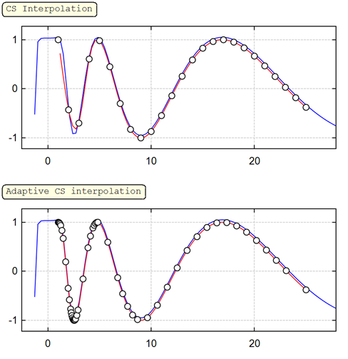

#8 Posted: 2018/8/31 01:21:49
CSplines with adaptive steps. Same issues, but now can use zero with units, at least in the adaptive case.
adapt cspline test.sm (83.25 KiB) downloaded 1174 time(s).

#14 Posted: 2021/12/6 03:21:27
Updated (Now it works again). Revised because the new develop of interpolation funcitons by Viacheslav at https://en.smath.com/forum/yaf_postsm75020_ODE-Solvers.aspx#post75020
This worksheet is about adaptive csplines and differentiation and integration of the splines.
cspline.sm (106.91 KiB) downloaded 1236 time(s).
