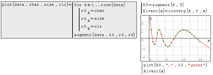

Hi. I have some issues in the attached.
Thanks in advance.
cspline test.sm (37,47 КиБ) скачан 1372 раз(а).

#4 Опубликовано: 28.08.2018 16:17:14
Two red will disappear if you use for loops instead of vectorization.

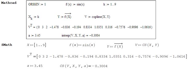

#6 Опубликовано: 29.08.2018 02:49:38
Hi Jean. There are not to much shadow in that small code. It's just the implementation of the traditional spline interpolation. In SMath there are not, or I can't found, the function cspline. The interpolation with cinterp in SMath evaluates the vector V each time that you call it, it's always better to have V=cspline(X,Y) and then call interp(V,X,Y,x). Finally, I want to implement an adaptive step size for the intervals in X. But first I see very convenient to have vectorization and plotting issues solved.
CS only do what mathcad's cspline do:
#7 Опубликовано: 29.08.2018 16:16:49
CS only does what Mathcad's cspline does:

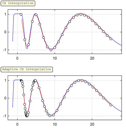

#8 Опубликовано: 31.08.2018 01:21:49
CSplines with adaptive steps. Same issues, but now can use zero with units, at least in the adaptive case.
adapt cspline test.sm (83,25 КиБ) скачан 1351 раз(а).
