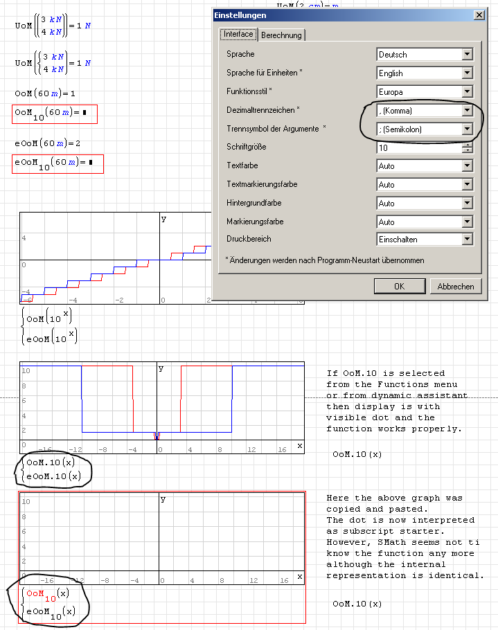

#5 Posted: 2012/10/3 09:18:31
1,355 likes in 2,271 posts.
When trying the plugin I had some problems with the functions OoM.10 and eOoM.10. They are related to non-standard settings of decimal delimiter (Komma) and argument delimiter (Semicolon), see image. With standard settings (decimal delimiter dot and argument delimiter komma) no problem.
When choosing the functions from the menu or from the dynamic assistant, they appeare verbatim (i.e. with visible dot and without subscript formatting) but work correctly. If the expression is keyed in or created or copy-pasted, then formatting is done but the function is not known to SMath any more.
Also, if the sheet with the correctly working but incorrectly displayed function is saved and than re-opened, then the display is correct and the function is unknown.
May be the plugin is not to be blamed for this, than this would be a bug in SMath, but I can't tell.
Best regards, Martin Kraska

#6 Posted: 2012/10/3 11:13:13
1,443 likes in 2,935 posts.
Fixed, thank you
P.S. same issue will be fixed on the next relase of NonLinearSolvers.dll (Homotopy solvers)
best regards,
w3b5urf3r

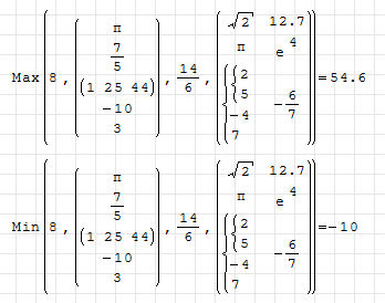

I have some problems using the Min and Max functions from the customFunctions plugin. It is NOT a custom delim settings issue.

#9 Posted: 2012/10/15 13:59:56
Thank you,
bug fixed and plugin updated b)
regards,
w3b5urf3r

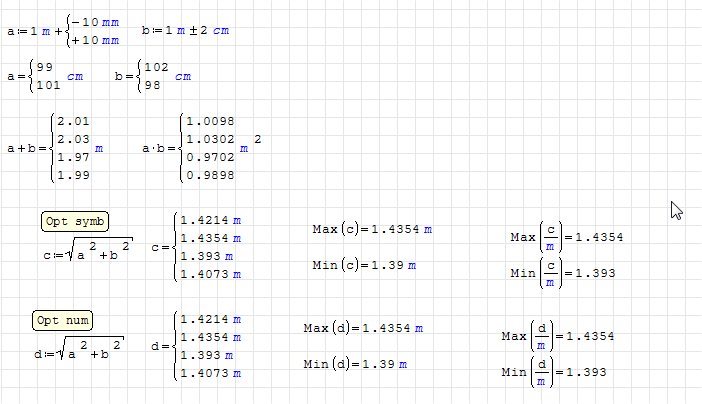

#10 Posted: 2012/10/15 16:34:22
Thank you for fixing the bug, Min/Max work fine now. However, there is a strange OS message when running your example file. It says something like "object reference not pointing to an object instance" or whatever might be the correct translation. It is not an smath message as it is in german even if I switch Interface language.
Also, this is not delimiter related.
Best regards, Martin.

#11 Posted: 2012/10/15 16:56:53
ooops
fixed & updated, thank you again
best regards,

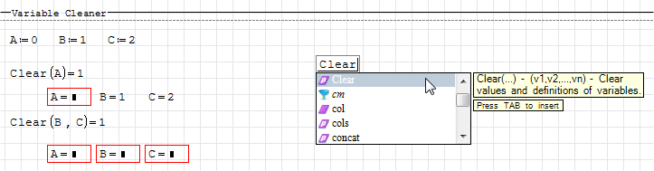

#13 Posted: 2012/12/14 10:19:50
PLUGIN UPDATED
Added new function Clear(...)
Many thank to [userlink]Rising Eagle[/userlink] for the great trick
best regards,
w3b5urf3r

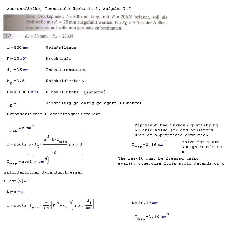

I came across a situation where using a Clear()ed variable is not equivalent to a virgin one. The attached example has two equations, where I introduce a dummy variable in order to solve for the numerical value of a physical quantity (because neither solve nor roots can solve for variables with units).
The approach allows to keep the equation readable and the unit used in the quantity split is arbitrary.
Instead of using a new dummy variable (x,y...) for the numeric value in successive solve operations I tried to always use just one variable. This fails by whatever reason.
The odd thing is that Clear(x) does not help... Thus we do not really have a Clear() function, or did I miss some detail?

#15 Posted: 2013/1/31 04:03:05
Hello Martin,
It seems that Clear() is not doing the job correctly. If I am not wrong Clear(x) equals to line(x), and I suppose it is missing something. If you use the line like Rising Eagle proposed
[MATH=eng]x:line(x,1,1)[/MATH]
it will clear the x and the following roots() using x will be Ok, but line(x) will produce this
[math=eng]x:line(x,#,2,1)[/math]
I do not know how w3b5urf3r escaped from this additional placeholder. If you just use Clear(x) it reported that everything is Ok (result 1) but by using roots() afterwards line-function not defined error appeared. If you use line(x) then there is an empty placeholder and the error would be Fill in all empty ellements. which is logical. Therefore, I suppose that Clear() function needs to be revised. Then, this will also do the job
[MATH=eng]x:line(x,x,2,1)[/MATH]
as could be expected
Davide Carpi 2013/1/31 05:42:00
#16 Posted: 2013/1/31 06:00:07
PLUGIN UPDATED
- Added SettingsDirectory(): show the path of SMath settings directory (e.g. useful to easily get the output path of built-in function wfile())
- Fixed issue in Clear() shown by Martin and solved by Radovan
[...] it will clear the x and the following roots() using x will be Ok, but line(x) will produce this
Thank you very much Radovan
For future reference of SMath plugin developers, the previous Clear() function was based on an hack that is possible working with low-level evaluation: x=line(x) (that is not x=line(x,1,1)).
best regards,
w3b5urf3r

#17 Posted: 2013/1/31 19:02:53
Hello w3bsurf3r,
thanks for the fix! Now that Clear() does the job I see that I have to freeze (using eval) results prior to re-definition of x. Thus the approach with re-using x is a rather cumbersome workaround for roots() not being able to solve for quantities with units.
Martin

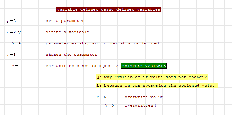

#18 Posted: 2013/1/31 21:39:57
Hello w3bsurf3r,
Martin
Indeed here I can see one of the (rare) situations where the use of the eval() function is clearly required :-p (see the attachment)
