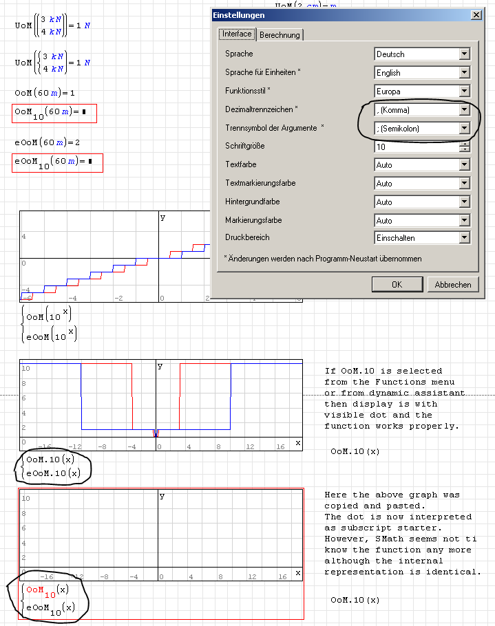

When trying the plugin I had some problems with the functions OoM.10 and eOoM.10. They are related to non-standard settings of decimal delimiter (Komma) and argument delimiter (Semicolon), see image. With standard settings (decimal delimiter dot and argument delimiter komma) no problem.
When choosing the functions from the menu or from the dynamic assistant, they appeare verbatim (i.e. with visible dot and without subscript formatting) but work correctly. If the expression is keyed in or created or copy-pasted, then formatting is done but the function is not known to SMath any more.
Also, if the sheet with the correctly working but incorrectly displayed function is saved and than re-opened, then the display is correct and the function is unknown.
May be the plugin is not to be blamed for this, than this would be a bug in SMath, but I can't tell.
Best regards, Martin Kraska

#6 Posted: 10/3/2012 11:13:13 AM
1,443 likes in 2,936 posts.
Fixed, thank you
P.S. same issue will be fixed on the next relase of NonLinearSolvers.dll (Homotopy solvers)
best regards,
w3b5urf3r
#7 Posted: 10/3/2012 11:57:07 AM
1,361 likes in 2,275 posts.
Fixed, thank you
Thank you! Works perfectly. (Thanks button throws error message)

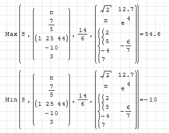

I have some problems using the Min and Max functions from the customFunctions plugin. It is NOT a custom delim settings issue.

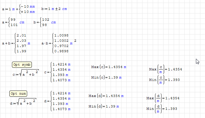

#9 Posted: 10/15/2012 1:59:56 PM
Thank you,
bug fixed and plugin updated b)
regards,
w3b5urf3r

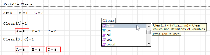

#13 Posted: 12/14/2012 10:19:50 AM
PLUGIN UPDATED
Added new function Clear(...)
Many thank to [userlink]Rising Eagle[/userlink] for the great trick
best regards,
w3b5urf3r

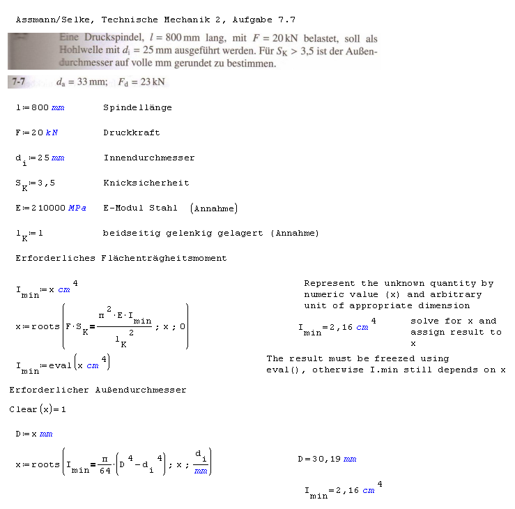

#14 Posted: 1/30/2013 7:52:04 PM
I came across a situation where using a Clear()ed variable is not equivalent to a virgin one. The attached example has two equations, where I introduce a dummy variable in order to solve for the numerical value of a physical quantity (because neither solve nor roots can solve for variables with units).
The approach allows to keep the equation readable and the unit used in the quantity split is arbitrary.
Instead of using a new dummy variable (x,y...) for the numeric value in successive solve operations I tried to always use just one variable. This fails by whatever reason.
The odd thing is that Clear(x) does not help... Thus we do not really have a Clear() function, or did I miss some detail?
Eventually I want to do some experiments with the NonlinearSolvers plugin.
AS 7-7solve.sm (100.55 KiB) downloaded 1805 time(s).

#17 Posted: 1/31/2013 7:02:53 PM
Hello w3bsurf3r,
thanks for the fix! Now that Clear() does the job I see that I have to freeze (using eval) results prior to re-definition of x. Thus the approach with re-using x is a rather cumbersome workaround for roots() not being able to solve for quantities with units.
Martin

#18 Posted: 1/31/2013 9:39:57 PM
Hello w3bsurf3r,
Martin
Indeed here I can see one of the (rare) situations where the use of the eval() function is clearly required :-p (see the attachment)

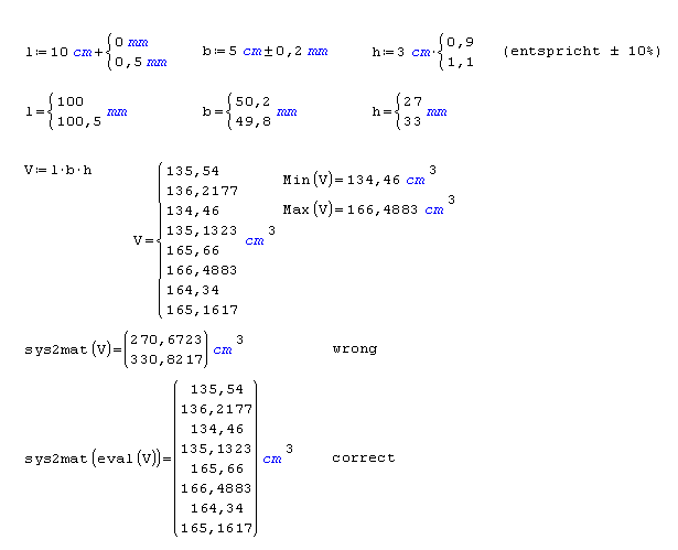

#19 Posted: 2/10/2013 12:21:36 PM
Hi w3bsurf3r,
I am surprised by the behaviour of sys2mat, see the attached example. Is this a bug or a feature? For the latter I see no good reasons (ok, i might be blind).
Could the function sys2mat possibly be redesigned such that it does not require eval() in order to produce sensible results?
Martin
#20 Posted: 2/10/2013 12:33:19 PM
Hi w3bsurf3r,
Martin
mhhh... probably it's a bug; indeed the sys2mat() function it's quite simple, I'll try to think something a little bit more sophisticated...
