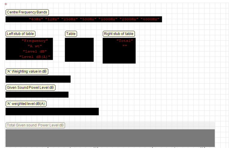

I have the same issue (0.99.7251.32800) with the acoustic file on https://en.smath.com/forum/yaf_postsm59725_Summation-of-log-functions.aspx#post59725
As soon as it was noticed, I gave the cure.
Why not suite the original thread ?

Why not suite the original thread?
Because it's still a bug that popped up on some of my other sheets. I also posted in the other thread
