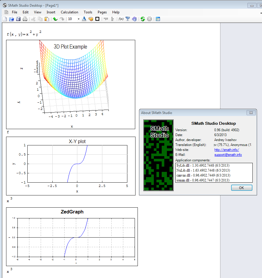

You can't use the old plug-ins with the regions. Therefore, a simple copy of the old version will fail. Do not use this way for old such plugins. As I said, they need to be recompiled with a small addition. New plugins can be copied. Do not use the plug-ins from my ftp, they are all old. Plugin Manager is not completed yet, Andrey is working on it. In any case, if there is a problem, try to remove all user's plugins manually from ..\SMath\plugins and ..\AppData\[username]\SMath\extensions\plugins, then install them from the gallery.
As for me, everything works fine:

#4 Posted: 2013/6/8 06:21:40
For me as well
